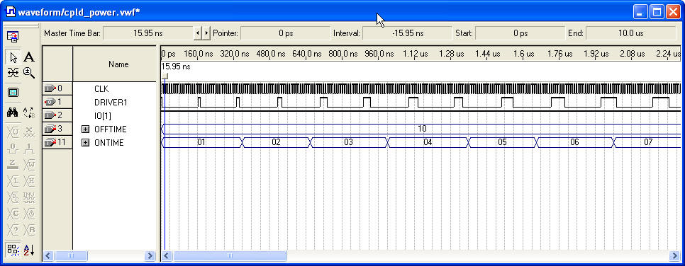

I am now using a CPLD(EPM7064STC440-10) and I have a problem. I want to use the CPLD to control the pulse duration. The VHDL source code is like that:
architecture art of cpld_power is
signal counter:std_logic_vector(13 downto 0);
begin

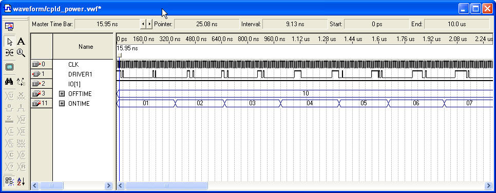

when I do the functional simulation, the output waveform is correct, see Snap1.jpg. But when I do the timing simulation, there is something wrong in the output waveform, see Snap2.jpg. I have done some real experiment on it and it was really like the waveform in Snap2.jpg.
How can I fix the problem?

solved
finally, i use a pwm controller and the problem is solved. the VHDL code:
pwm_fpga.vhd
