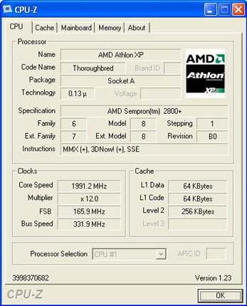

Run CPUz, in the clocks window the truth shall be revealed!
