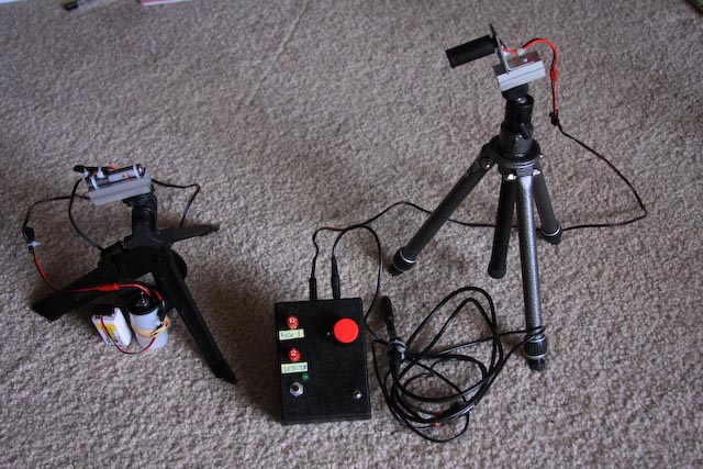

I read with interest your post and took a look at your photographs - very good indeed. I was in a similar position last year, although I'm merely an amateur wildlife photographer. Nevertheless, I wanted a remote camera trigger.
I built one which satisfies your basic requirements. I think you have the right approach, starting with the basics. As mentioned, the microcontroller would probably be best for implementing all your requirements, although much of it can be done with basic electronic components (e.g. 555 timer circuits).
As I'm self-taught and undisciplined I don't have any fancy circuit diagrams for you, however I can describe how I went about it.
The circuitry is basically made up of circuits found in Forrest Mims' Engineer's notebook Vol. 1. To understand the electronics/physics you'll need a book like mims' 'Getting started ...' book or Scherz's 'Practical electronics ...' book.

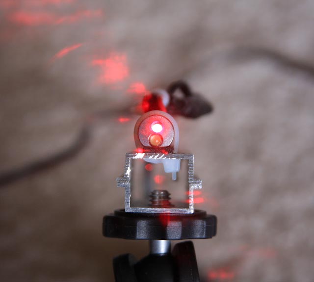

A) I use a laser-pointer, which is pulsed by a simple 555 timer circuit (e.g Mims). Flashing means that the laser is on only 10% of the time, and so the batteries last 10 times longer. more importantly a flashing light source can be easily 'differentiated' from, say, steady sunlight - which will be important if you want to use the device in daylight.

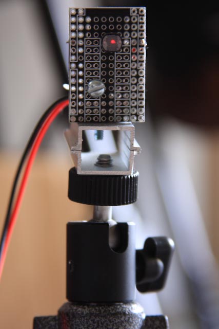

B) The trigger must obviously look for missing pulses (i.e when the animal breaks the laser pulse beam. Again Mims has a 'missing pulse detector' circuit. I actually added a 'high-pass (aka differentiator)' circuit before this in addition to a 'comparator' in order to separate the sunlight signal form the pulsed laser signal - the comparator essentially makes the result 'digital'. this is a nice clean signal (i.e. largely free from electrical noise) to feed into the 'Missing pulse detector' circuit. It's not essential though.

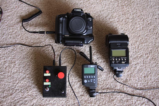

C) when the missing pulse detector circuit detects a missing pulse it fires a 'monostable 555 timer circuit' (Mims again) which send sthe trigger signal. the duration of which can be adjusted (i.e your 'pulse length' criterion). Actually the trigger signal fires a IR photoemitter/phototransistor coupler, which is what is equivalent to pressing down the shutter button. Note also, the camera is electrically isolated from the device.
I've attached some photos of the gear, the devices it can fire (camera, flash, pocket wizard all just require a short circuit to fire), and the laser and detector. The circuit that pulses the laser is in the film canister.
If you want two beams then you just pulse them synchronously and combine them with a basic 'AND' or 'NAND' logic circuit before entering the black box.
To fire multiple cameras I'd just have the deice fire a pocket wizard which fires several cameras (each with a MultiMax pocket wizard attached - expensive, but versatile). Alternatively you can achieve different delays by using 555 timer circuits. The 555 chip is an amazing thing.
As for your 'Bulb mode': my speedlite flashes have a strobe mode, so that functionality doesn't need to be built into the laser trigger.
Most
as I was saying... to achieve all of your criteria I would look at a microcontroller, although the wonderful 555 timer chip is capable of doing the job.
If you were wondering, the big red knob is the pulse duration. The two small red knobs are for tuning the device to the incoming pulses and adjusting the sensitivity of the detector. There's a green LED confirmation light, and a test-fire button to simulate an event.
Incidentally, since the laser is on only 10% of the time, it rarely appears in a photograph, and even if it does the laser spot is usually invisible, being so much fainter than sunlight. The detector is just a CdS detector hidden at the end of that black baffle.
Wrap-up: most trigger devices use a steady laser beam, and this is much easier to implement, although with Mims' circuits it wasn't difficult for me to do. A few months ago I started to look into microcontrollers in order to design a trigger that has all the functions you describe. To be honest teh commercial triggers don't do anything that we homebuilders can't make ourselves.
