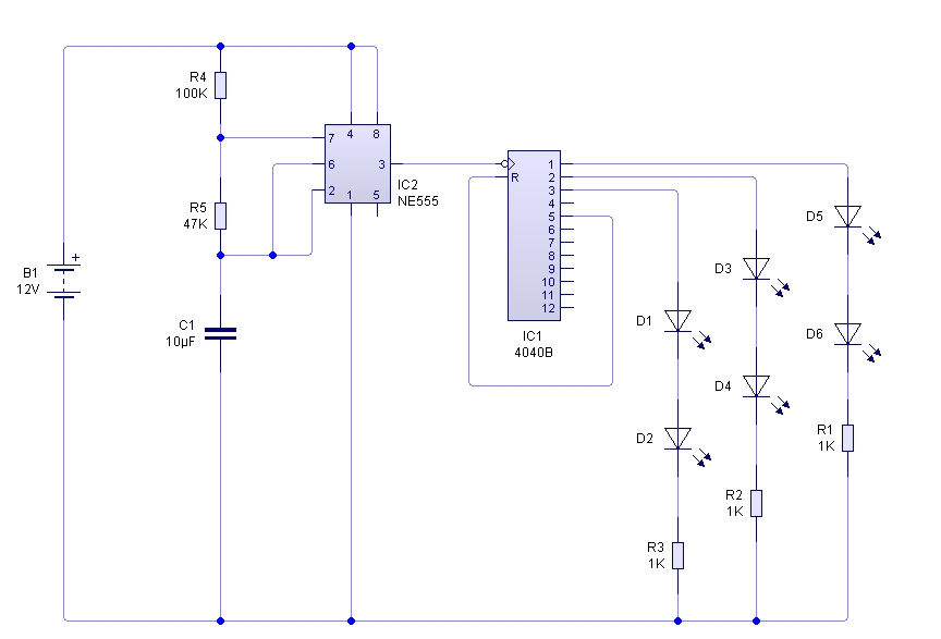

I am not only a noob but completely ignorant regarding this kind of electronics (all kinds really). I am trying to create "critter lights" for my back yard as an evening feature. I put some boulders together in the form of a "cave" with the idea that in the evening when my landscape lights come on I could have some "critter lights" create a little interest. The opening to the cave is about 8"x10." A friend of mine suggested a ciruit board for the lights and timing mechanism. The low voltage transformer provides 12V and I have 58watts remaining after the landscape lights. I can not describe in words what it is I am looking for so I created a gif image.
If anyone can help with a schematic for this sort of thing or other resources that might help I would greatly appreciate it.
Threw this together kind of quick, mostly just a basic idea. You will need to play with the values some to get the effect you want.
A 555 is used for a clock source to feed a binary counter. You can have up to 12 pairs of 'eyes' if you wish, just remove/move the Reset line. I used kind of a high value for the current limitting resistors, but you might want to go even larger, as I don't think you want the LEDs to be full bright, othe wise they will light up the cave interior.

I would also recommend the 4060 which includes the oscillator so there's no need for a 555.
Since the 4040 and 4060 are ripple counters, each set of eyes will flash at half the speed of the one before it: the first flashing once per second, and the last flashing once every 2 hours or so.

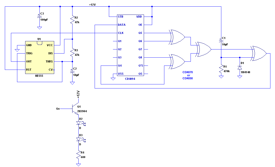

With a 4017 and a couple of XOR gates you can make a linear feedback shift register. I just searched the web and didn't find any simple circuits, but I'm sure the other members here can come up with one.

I don't think you can make a LFSR with a 4017. The 4017 is a 5-stage Johnson counter with decoded outputs. A LFSR requires a shift register and one or more XORs.
Here's an 8 bit LFSR that should work. I simulated it, but I have not built it. Eight bits is probably overkill, but it might be fun to play with.

Will the 4040 take 12V?
