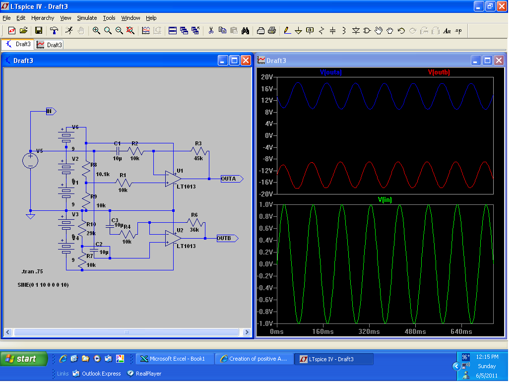

I'm not sure I understand your virtual ground statement, but is this what you are after?
You would need to buffer the outputs with a rail to rail op amp to get your 50ma.
PS. You could get rid of the 3rd battery if you use a rail to rail op amp instead of the one I chose.

Many thanks Ron for your interest, and to the otheres who responded. The circuit you kindly provided is almost exactly the type of thing I had in mind.
Just two questions please to finalize. 1) Why are the two output sinewaves out of phase? What change to the circuit is required to have them in phase?
2) What I meant by the "virtual" grounds at 9 and -18 volts is this. The top amp would be powered by 18 and 9V, and the bottom one by -9 and -18V. You can see in both cases the potential is 9V, but the two supplies do not have a common. In this case, I believe the input signal would need to be AC coupled. Can you please advise how to change the arrangement of the batteries and components on your schematic accordingly? Even if LTSpice may not run the sim.

That's not the picture I got at all in terms of what you wanted because the outputs are not swinging from -9 and -18 volts.
1. One Op amp is a non-inverting configuration and the other is an inverting configuration.
2. One potential problem is that the offset is not provided by a reference and would vary as the battery is depleted. Note that his circuit is not isolated either. You can't get an 18 V or -18 V swing with an 18 V power supply. And as Ronv mentioned, it doesn't have enough current output. A transformer could do the isolation and/or inversion, but now you would need more batteries.
I thought you wanted amp A to be at -18 and AMP B to be at 9 and when B is at -18, A would be at 9V. That circuit doesn't satisfy that, if that is what you wanted.
You basically can place the offset at the input or the output by summing. In order for a summer to work properly, it has to be driven by a low Z source. I hope Ronv will confirm my concerns.
Hard to do. Here is the picture. Scope probe a is on output a. Scope probe b is on output b. Where is the scope ground?
RonV, thanks again for your reply. I understand what you mean with regard to the LTSpice scope. But the circuit could still be built without a common earth, (+18 & +9 and -9 & -18V rails as described). The input signal is AC coupled so the offset voltage of the op amps' virtual ground presumably does not affect it.
With regard to the circuit you previously provided, can you please advise what is the purpose of the 10uF cap between the non-inverting input of the bottom op amp and the inout signal to the top one?
Also, why are the two output signals in the sim anti-phase?
I am getting ready to build one and I would like to understand fully the principles involved.
Many thanks.
Sure the circuit can be built without the common ground. But without a reference anywhere you can't define the voltage levels. If you want to use the virtual grounds as a reference that is ok, but then you need to define the output with respect to those reference(s). I used the capacitors to couple the single source to the two circuits without tying the two circuits together. (DC wise) The circuits are out of phase because one inverts and the other does not. This can be fixed with another inverter or maybe a redesign of the current circuit. I can break the two circuits apart and have spice happy with it but like I said in the prior post you need to tell me where to put the scope probes, Spice or real, and what voltage you expect to see because there will be no relationship between the two circuits at that point.
Wait. I think I get it. If the circuits are completely separate I can define the virtual ground on each of them separately? So you really don't care about one circuit in relationship to the other - only to itself?

Yes, as RonV points out, the design can be dealt with as two separate amps. One with a +18 and +9 supply, and the other with -9 and - 18. So the virtual grounds are +9 and -18 respectively, and they are obviously not connected to each other.
Since Ron's latest post I have built up the circuit he kindly provided. I had only 2 NE5532's, not the LT1013's specified. Unfortunately, the output waveforms were clipped, I suspect due to connecting the ground lead of my function generator to the +9 and -18 virtual grounds respectively. Although it does not seem to affect the amps' input signals.
Perhaps someone would be so kind as to set me straight on this. I am beginning to think I need a proper signal ground at 0 volts. I have a attached a schematic diagram including this change in the hope of attracting some further comments. I have also uploaded RonV's original LTSpice for comparison.
