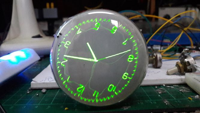

Finally got time to work on my oscilloscope tube clock, well radar tube.
The image was very blurred, turned out the deflection (elctrostatic) amp was getting noise over the supply from the switching converter I put together that generates the voltages for the anode, focus, brightness grid and cathode.
I got this to improve filtering the supply, however now I have this odd blurry image on one side of the tube, clear on the other, reversing the deflection plate wires inverts the image but doesnt invert the blurred side of the tube, moving the image around with the centering pots brings the blurred part clear if I shift the image all the way across, so what was the blurred side of the image is on the other side of the screen.
Have I got a dead tube?, or is my fairly small amount of experience with crts biting me again.
The clock uses vector graphics from an esp32 dac outputs.

The deflection is symetrical, I'm using a long tail pair made from ztx458', one tranny is biased with a pot which controls image posiiton, and the other has the dac signal from the esp applied, I wonder if theres an impedance thing, the pot is 50k, the signal side comes direct from an op amp so will be very low imp, might try a 47k resistor in series.
I removed the op amp altogther, and connected the dac from the Esp direct to the deflection amp via a 5k pot 'volume' control.
It worked, number 8 ever so slightly out of focus, but acceptable.
Then over time it blurred a little, still not so bad, but the image is now clipped, seems like the o/p of the esp isnt happy, its the same connected to my 'scope in xy mode, without this circuit connected.
My original Esp32 module literraly blew up I accidently connected 400v to the dac o/p, oops, as a temp measure I'm using a Esp32 cam module, which doesnt have gpio25 & 26 (dac out) brought out to pins, so I soldered wires direct to the chip, I'm now thinking there might be some analogue stuff on the dev kit module that I'm missing, will have to wait till the couple I oredered show up.

In the post box when I got home, 2 new Esp 32 dev modules.
They are different, the image is much better, however I tweeked the circuit a little, I put a non inverting unity op amp buffer with a op amp virtual ground inline with the signals just after they come from the Esp.
The image is now probably as good as the 1947 therminoic picture tube gets, the retrace lines dont show with the naked eye, and the face isnt quite round, I'm having issues with trim pots shoved in breadboard.
you can probably eliminate the retrace lines by adding some negative bias to G1. that's the thing about vector graphics, you have to drive G1 into cutoff pretty hard to eliminate those retrace lines
Well you cant see them, just the camera does so I'm not that bothered.

Believe it or not that tube is well used, theres a failry large burn blob in the centre, the second hand shows it on the pic, again in real life you have to squint to see it.
