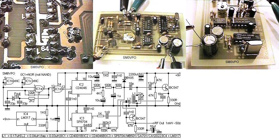

Oh sry :oops: i missed that. My transmitter is extremely small, a little bigger than a pink eraser. I want my transmitter small; is a phase locked loop system small enough for a small transmitter? also, what kind of variation in frequency can you get from it? I read a definition on google, and it mentioned that it is used to step up frequency or something like that.
Here is an example.I found this about years ago somewhere on the net.
That's quite nice! - but rather too simple, it just provides a single frequency based on the crystal.
A full PLL tuning system uses programmable dividers to adjust the frequency, and gives a large tuning range in channel steps as small as you want to make them.
But I suspect a PLL system is probably too complicated for what he wants!.
The simpler form of 'adjustable' crystal oscillator is probably VXO - just small variable capacitor that's adjusted by hand to get a little bit of range. I agree that replacing the variable capacitor with a varactor (or other) diode and a pot is still pretty simple.

**broken link removed** is Harry Lythall's article that accompanied the schematic posted by Sebi. It has a good discussion of the problem, and how he got around it with a PLL.
