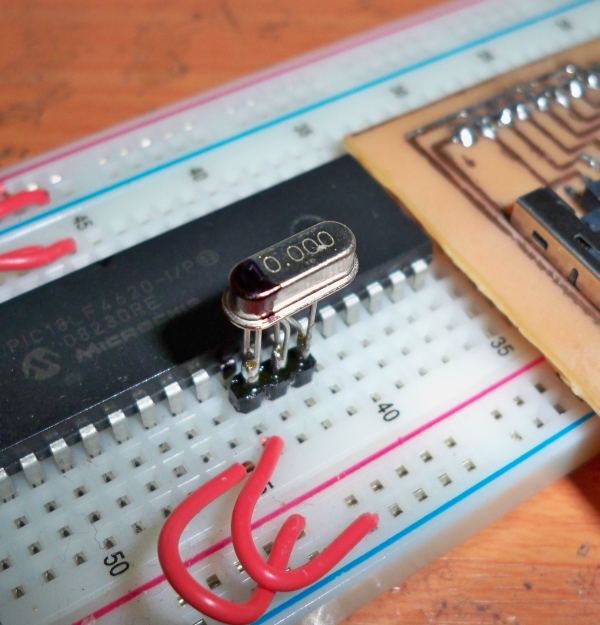

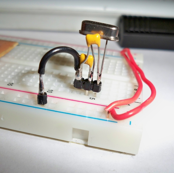

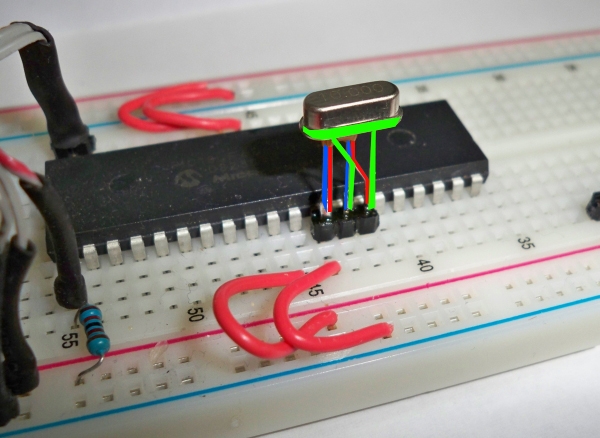

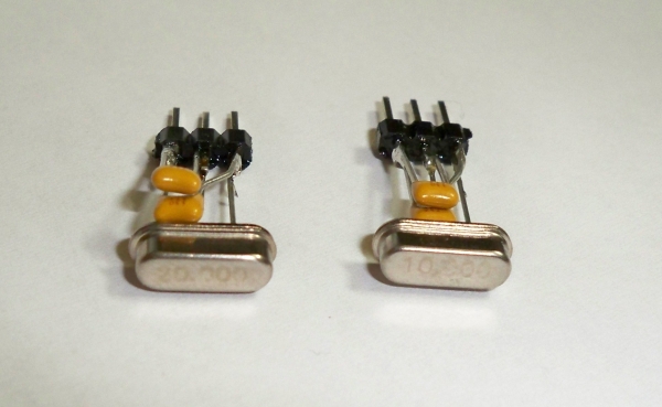

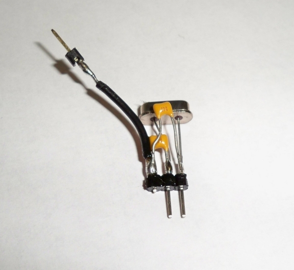

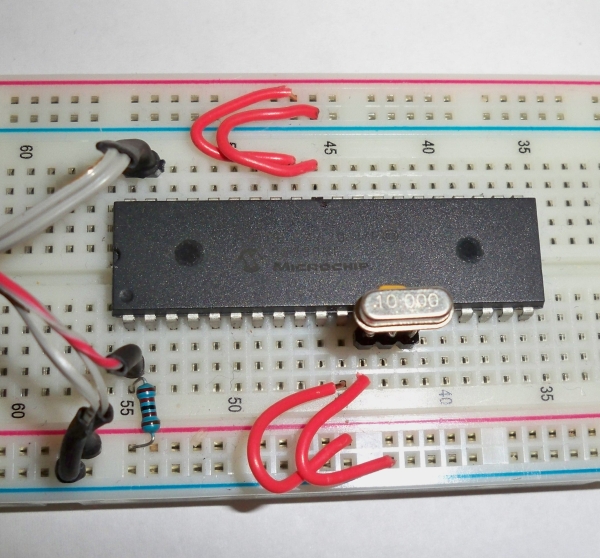

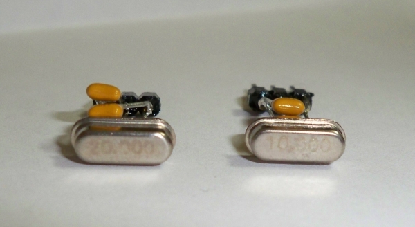

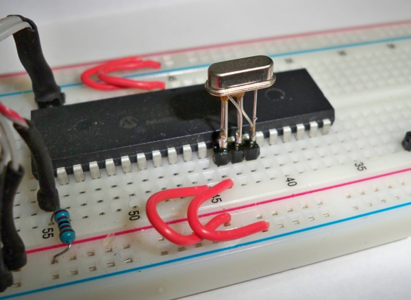

hey guys i know messing with crystals on a breadboard can be a small hassle. i just realized i never showed anyone how i deal with it and decided to share my tip.. if you can solder then you can do this... below are pictures of a 10mhz and 20mhz crystal and 2 caps tied to 3 pin header. so you can simply plug and play. i have not ran into any issues using this yet so... anyway here are the pictures and feel free to recreate and use these as much as you want:

Very clever! It's the simplest things that show real brilliance. :)
Maybe a possible improvement would be to put a black sharpie spot on the side of the xtal that is the ground pin?
The middle pin is the ground pin. The outer two pins go to the crystal leads.
Neat idea though. It makes you wonder why crystals don't come with the caps built in. Probably because different applications need different cap values?

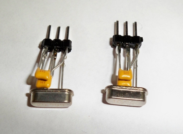

nope the left end pin is ground. This is so you can plug and play to a breadboard.... ill take a pic:

Soldering the caps to the crystals like that makes it a nice module but I don't get the reason for it being an inch tall.
That's brilliant but that wont work on my 18 pin uC as the positive pin is next to the crystal instead of the ground :(
im thinking of making pcb modules with right angle pins.... ill talk to a friend and see if he would like to make some PCBs and sell them with pin header only. this way users can install there own caps and crystals to customize the application.
Some ceramic resonators come with capacitors built in.
You can connect the capacitors to +ve instead of negative, as long as your suppressors are large enough.
Alternatively, just use an oscillator. Much easier.
