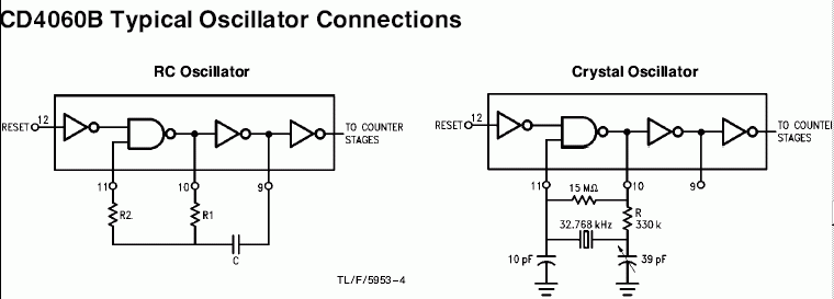

I will be designing an elapsed signal pulse timer.
it will count from 0.00000 to 9.99999 seconds.
so, I will nead a 100,000 hz generator.
The idea is to use a 6.4 meg Hz crystal and cmos 4060 to divide by Q6(64) to give me the 100,000 Hz.
then counting with 6 4026 seven segment counter/led driver ic's.
I bought a 6.4000 Meg Hz. Crystal.
Connected it to a cmos 4060 chip, and It seems to be working fine.
Instead of the 10pF and the 39pF Trimer cap, I use two 22pF caps as thats what I had handy.
It seemed to run fine.
the out put of the chip was devided by Q(cant remember) to give an audio frequency that mached the tone from a downloaded pc tone generator.
Test cunducted by ear.
I also noticed that if I removed the caps, the crystal still seemed to function the same.
Is it better to not use the caps?
Question:
is the 39pF trimmer cap used to increase the /decreace the frequency?
I don't want to increase/decrease the frequency.
I want it to run at exactly 6.4MHz.
How do I know that the frequency is exactly 6.4MhZ and not 6.4035Mhz?
I don't have a mutimeter with Frequency function, and I think all multimeters have an error percentage anyway.
I know nothing about this field.
But do you think the crystal is outputing the exact 6.4000 MHz?
I guess it should , since it has 6.4000 printed on the crystal.
thanks
Here's a part print screen of a 4060 data sheet
The capacitos are for the stability of the crystal.
Multimeters cant meshure that high freq. they mostly meshure up to about 100 kHz.Freqency counters do it or you can do that whith an osciloscope.
The capacitors are an essential part of the oscillator circuit, it 'may' work without them due to stray capacitance, but it's important to leave them in place!.
Question:
Yes, to trim the crystal to exactly the frequency you want.
You need to accurately measure it, a standard technique is to compare it to a reference frequency, most countries have some reference radio transmitters, very accurately set to a specific frequency. You can 'beat' the harmonics against each other, and adjust for zero beat (rather like tuning a guitar! - in fact, thinking on, EXACTLY like tuning a guitar!).
Using a tone generated from a PC is likely to less accurate than the unadjusted crystal :lol:
thanks
Unlikely!, you need to adjust the trimmer so it's exactly correct - but do you feel lucky?.

should I use the same capacitors as in the data sheet, even thou I'm useing a much higher crystal?
Thanks guys.
Even if you tune it to exactly 6.400MHz at a particular temperature, the frequency will change with different temperature.
You needs some means to keep the crystal oscillator at the same temperature if you want stable frequency output.
Why not use the capacitor values (minus stray capacitance) that are spec'd by the crystal manufacturer?

Mechie, It's running 0.02% too fast.
I'm getting an error of 18 seconds per 24 hours and thats using that 39pf trimmer on that data sheet.
Looks like I nead to use more pfs then the 39pf specified.
Is it ok to us more?
I also did not use a voltage regulator.Does it matter with crystals?
i used 4.5Volts (3* 1.5 volts AA batteries)

Have you zero beat the oscillator against a reference source?, or how have you set it up?.
I would expect the frequency to change as the batteries go flat, digital watches do!.
What does 100ppm mean?
ppm is "parts per million".
Nigel asks
I bought some more caps to tune it (27 pf on both sides of the crystal).
I hooked up the seconds pulse of it to the parallel port.
Wrote a program in QBasic to tell me the time when the port receives a low/high input signal.
Qbasic's timer command has a resolution of 0.01 second.
I'm now getting an error or 0.01 second every 3000 seconds.
or an error of 0.28 seconds / 24 hours when compared to my pc clock. I think my pc clock is accurate to within a second per day when updated daily from the internet clocks

Screech said:
Nigel asks
The crystal is tuned by altering the DIFFERENCE on the two sides of the crystal, so by adding to BOTH sides you're not really changing anything 8)
:D :D :D
Sorry, but that's a REALLY poor way of trying to adjust it, the accuracy of the QBASIC program is going to be pretty poor, nowhere near as accurate as your untrimmed crystal!.
As your resolution is 0.01 seconds, by definition the accuracy can be no better than + or - 0.01 seconds, and the way the QBASIC timer command works will make it worse than that!.
Nigel says
