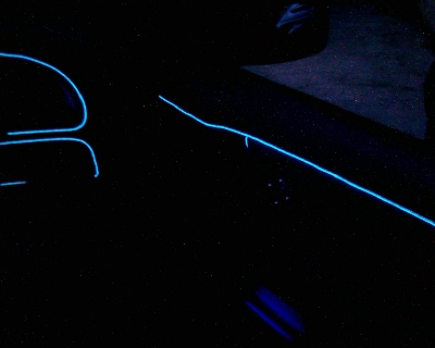

This is my little brothers Ford Mondeo ST24, glowire trim around the dashboard , E-L sheet light the door pockets and allthough it does not show very well on the pic the led's in the switch clusters on the door for the windows have also been changed to blue.

I am gratefull there is someone here with the will to help and I appretiate it, on a note, I had thought of the wire, also called "EL wire", but the light output is not enough, its mostly like to accent an area, LED is far more brighter and has more customizable applications, I tried to figure out the page link you sent me, but not realy sure how to complete this project, if it is not too much to ask someone here, what kind of (very bright - blue)LED's would I need for a 10 LED bar-and what resistors for them, i assume its one resistor per LED?, the soldering I pretty much can figure it out, just also, how to solder them in a series to were i just connect the hole thing to one power input (vehicle's 12 V) I plan on making three of these, one for driver side, passenger side and front grill ...if there is someone that could help, that would be great...consider it your day's good deed?...LOL :D
