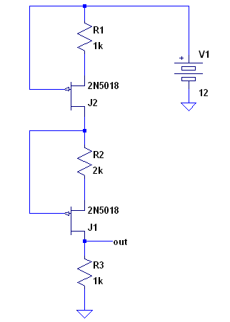

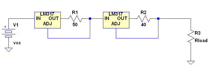

And - Show me two (or more) current sources that is connected in series. Schematic should be provided :D

To connect two current sources in series (although there's unlike to be a practical reason to do so) just use two lab supplies with isolated outputs, each configured to output a constant current.
Current sources in series.
This schematic kill the idea about the current source providing the least current will be damaged. This must be considering a safe current source.
But this drawing shows not two independent current sources as they share the same voltage supply. So the very damaging way to connect two (theoretically) current sources must be different from this.
