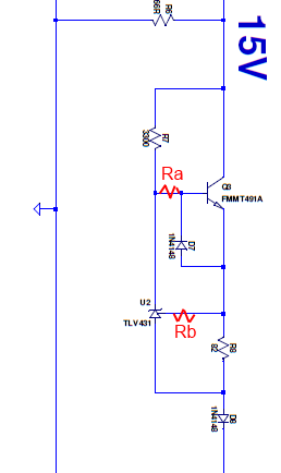

We have a DALI power bus comprising a 15mA current clamp in a 15V rail. (as in attached schematic)
As a test, I turned on the transistor, Q4.
When I clipped a TA041 differential probe across the 82R resistor, I saw a 50MHz sinusodal oscillation across this resistor, of about 250mV pk2pk (I was using a 50MHz scope). The current in the 82R was on average less than 15mA, …about 11mA on average.
When I unclipped the Diff Probe, and instead attached a normal scope probe across the 82R, the oscillation was gone, and I saw a perfect 15mA of current flowing in the 82R resistor as it should. (1.24V across the 82R resistor).
I may be being pedantic here, but I want to solve this oscillation. (even though it only happened when the Diff Probe was connected). Do you agree that a good way to damp out this oscillation is to put an RC series circuit from Collector to base of Q3? ( Values about 10n, 10R)
I’ll provide more info later when I can get back to the lab if it's ok.

I'd guess that you were effectively adding a small capacitance across the ground and sense of the TLV431, causing a lag in it's response to changes in current so it was over-compensating for the variation each time it "caught up".
A very small added base-emitter cap, or the RC from base to collector, should reduce it, by slowing the transistor response to match.

50mhz? That is too fast for the 431.
I would try Ra in the range of 100 to 1000 ohms. This will slow down Q3. It is the only thing that fast. Not slowing down by much, just enough that it has no gain at 50mhz.
I would also try Rb. The input of the 431 should not be driven by a low impedance source. Some resistor in the range of 1k to 10k. If the input of the 431 is driven hard above the reference voltage it will work strange.
