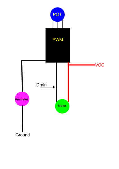

The normal basic PWM has a N channel mosfet,so the negative of the motor is connected to the 'drain' of the PWM,
the positive is common to both the motor and PWM+ ,the negative (ground) is connected to the 'source' of the PWM. Bear this in mind:- the case of the mosfet is physically connected to the 'drain' pin of the mosfet, so the heat sink should NEVER be grounded. The current is adjusted by the potentiometer that is installed on the PWM circuit board,or by remote if you extend the wiring from it.An analogue ammeter can be connected in series with the negative supply.If you intend to use a digital ammeter, a shunt must be used if the ampage exeeds the rating of the meter. I could create a diagram if you need one. Give some indication as to what device you are controlling,
voltage,max current draw ect; If you intend to run the appliance at the constant maximum ampage,you will need to make sure the PWM is suitably rated to cope.

duly noted. we are controlling the current. can you create a diagram to be used for referencing purposes.....thanks so much....
PWM Diagram
Try these for now,any thing else, let me know. Terry.

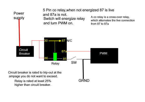

This is the circuit I use to switch on the unit and protect it from over loading,I use a re-setable cicuit breaker,
rated so that if the maximum ampage of the PWM is exceeded it trips out.

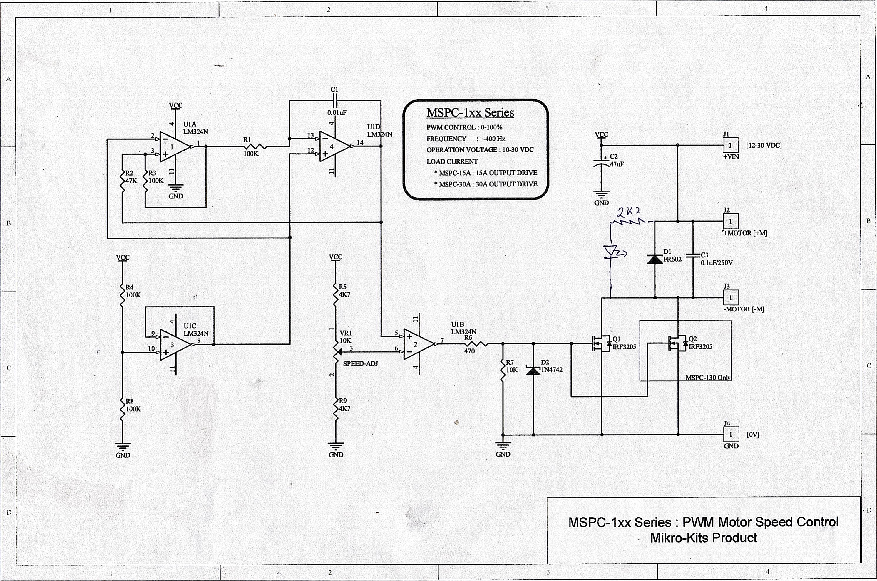

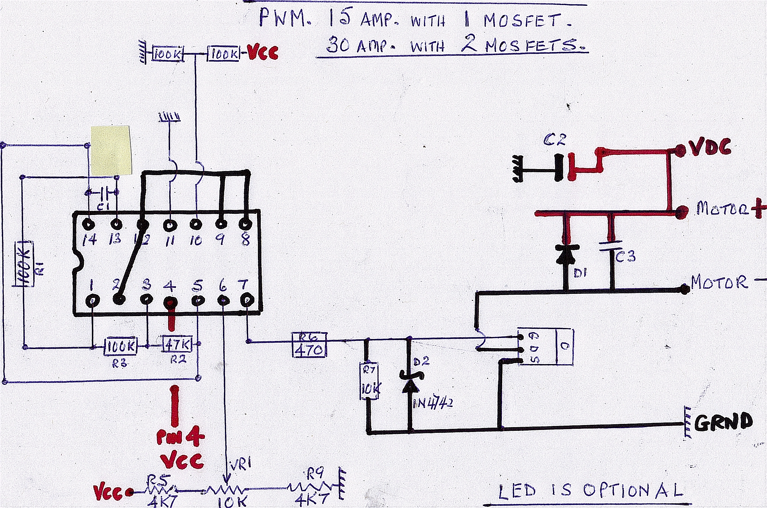

tblo163, in post #14, in the second diagram..what are you using to represent the big block with numbers? is it an IC....?
It is an IC, it's a LM324N Quad op Amp 14 pin, this IC is the most commonly used for PWMs.
it has 4 transistor cicuits,so there is no need for any extra transistors,I,ve sent you the data sheet.
I allways use a 14 pin socket to mount the IC, this enables you to insert the jumpers for pins 2,12,8 &9,under the socket,and it saves soldering the IC directly. Terry.

PWM PDF Improved version
This is an improved version, with the schematic and components list Terry;
