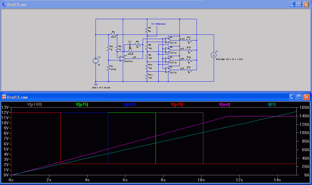

While it might be better to use a current transformer on the secondary, it might be simpler to use a simple current shunt on the primary to measure the current. Amplify the shunt voltage and feed it into some comparator having appropriate reference voltages. See attached schematic for details (note the 1p capacitor should be more like 100n, it's 1p just for simulating).
As the input 12V is unlikely to be regulated, you should attach a better reference voltage where indicated on the cct. R12-15 are the relay coils (put freewheeling diodes across the coils of course).
The shunt 100uR can just be a section of the power cable (e.g. just tap 2 points in the cable to connect the 1k resistors to. You may need a noise-decoupling cap across the inputs also.
As an improvement, you could reduce the gain of the differential amp and follow it with an adjustable gain amp; this will allow the shunt to be most any arbitrary value and improve amp stability.
Hope this helps.
