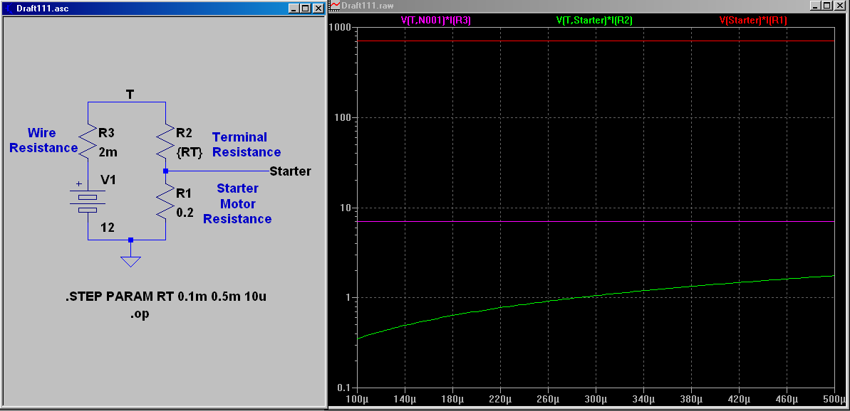

Look at the circuit below. Notice what happens to the power lost at the terminal as the terminal resistance goes from ~0.2m to 0.4mΩ, such as what might happen if you replace brass with copper.
Note that the power in the starter motor (red trace) is ~700W, with the power lost in the wire (purple trace) is ~7W, while the power lost in the terminal is ~1W, a tiny fraction of the total. If you reduce the power loss in the terminal from 1 to 0.5W, BFD!!!!
Selection of terminal metallurgy is usually driven by compatibility with the wire...

It's true that the resistance of brass and steel terminals are higher than copper but the terminal resistance is only a small part of the total resistance that determines the current flow. This includes the battery resistance, the wire resistance, the motor equivalent resistance when cranking, and the frame resistance (the current return path).
So even though the steel terminal may have significantly more resistance than a copper terminal, it's likely still a small portion of the overall resistance and thus only has a small effect on the current flow. Changing the wire to a larger gauge probably has more effect in reducing circuit resistance then changing the terminal material.

That statement, "steel only flows some percentage of what copper flows" is the problem. Throw it out. That "specification" is worthless.
Yes, all losses turn into heat.
Other people here have explained very well how to add up the losses of each part and how to do it correctly. Trust them.
