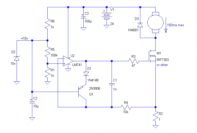

If you want to try an electronic limiter, I designed the one below. It has been simulated, but not tested. The 741 op amp is not my first choice, but it is available and will probably work. The MOSFET needs to have less than 0.1 ohms Rds(on). You should put a small heat sink on it - enough to handle 4 watts in the case of a direct short across the motor.

Question for the forum: What is the problem with a current limiter? Is it startup current? Otherwise I don't see the problem, so long as you are certain that the motor will never require more than 150ma under normal load.
The limiter I posted has a an output impedance of about 1 ohm at less than the limiting current, so you will lose less than 150mv under normal loading. This impedance could easily be made even lower, perhaps as low as 100 - 200 milliohms, with some simple changes.

The idea I had, but rejected, was a mod to the circuit I posted which would delay the limiting when power was turned on. The problem I had was what to do if the motor was stalled, and then was released. Power-on delayed limiting would not handle this situation.
