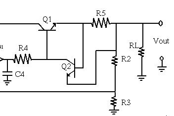

anyway .. how do these current limiting circuits like the one below work (R5 & Q2)
ive read that the voltage over R5 is not sufficient to switch on Q2 until a "larger" current is produced
but isnt Q2 switched on .. and just not able to conduct? as the +ve voltage is at the emitter side?
it would be helpful if someone could explain the circuit in simple terms (for a simple person)

I did not completely examine the circuit, but it appears that Q2 is not operating as a switch. Instead, a voltage difference across R5 changes the current through Q2. That current will "pull" base current from Q1, which lowers the emitter current of Q1 and effectively limits the circuit current.

When the load increased to 100mA, the output is 9V - 0,68V so the emitter voltage about 8,32V the base remain 9V. The NPN transistor can open if the base voltage about +0,68V higher as emitter voltage, and this is independent what voltage sitting the emitter.
current limiting
Pertaining to the firs circuit that was posted. When the voltage drop across R5 equals approximately 0.7 volts, Q2 turns on and the voltage on
the collector is approximately 0.2volts more positive than the emitter voltage.
