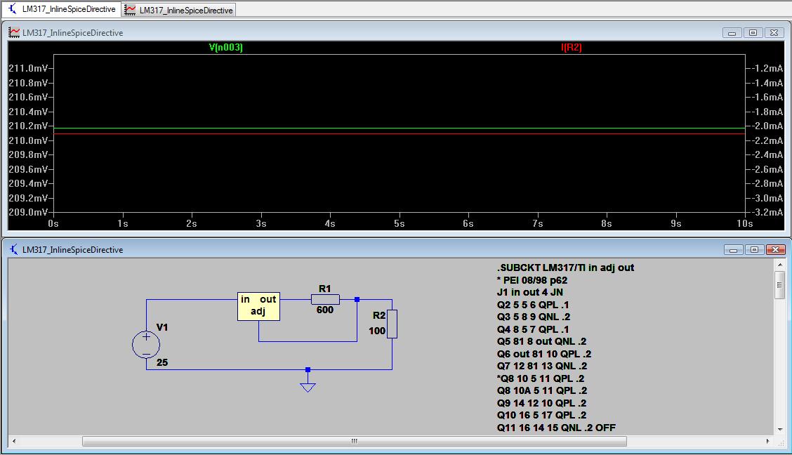

I have a device which requires very low current (2-5mA) and 20V.
I tried with LM317 using but, but I am not able to get the require voltage.
I also tried with JFET but still i am not able to get the voltage..
My device's output impedance is "100 ohm"
when i connect the 100 ohm resistor as load to the LM317 or JFET circuit , i am able to get voltage in mili volts.
my input ratings are Vin = 25V / 200mA
and i want Vout = 20V / 2~5mA
in less cost..
i have heard about current regulating/limiting diodes but they are too costly.
can any one help me please..

hi and welcome.
With a constant current source of 2mA to 5mA, into a 100R load its not possible to get 20V across the 100R.
What is the type of 100R load, ie: what is the 20V at 5mA for.?:)

Minimum load current for an LM317 can be as much as 5mA, so additional loading may be needed.
the "100 ohm" resistance is my load where the sensor will be connected(its sensors impedance i used in simulation)..
and the ratings of the sensor is 2-20mA more than that will destroy the sensor..
the sensor itself is very costly so i am trying for 2-5mA ratings.
is there any other device other than LM317.

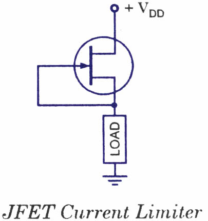

I would use a JFET for the constant current, much more stable than a LM317.

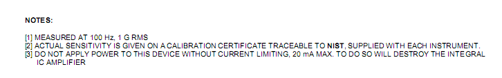

[3] DO NOT APPLY POWER TO THIS DEVICE WITHOUT CURRENT LIMITING, 20 mA MAX. TO DO SO WILL DESTROY THE INTEGRAL IC AMPLIFIER
I concede, you do need a current-limited source :)
All that means is the required voltage is 18-30V. The sensor will draw 2-5mA at whatever voltage you supply.
Do NOT connect directly to a +Vsupply, it will be damaged.!
Construct a 5mA or 10mA Current LIMITED source say at 20V

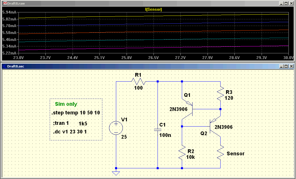

Here's one way:-
The graphs show the current limit for a V1 range of 23-30V and a temperature range of 10C-50 C.
Increase R3 to reduce the current limit.
R1,C1 limit any supply spike but may not be needed.
I also tried with JFET.
as i connect load 100ohm it gives me 240mA
so not able to connect with the JFET also..
please suggest me some design for this..

No. If the sensor draws 20mA from a 30V supply it is acting as a 1.5k load, which is the value I used in the sim.
Here's the .asc file

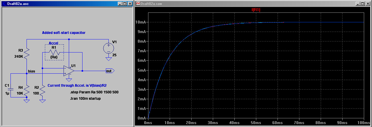

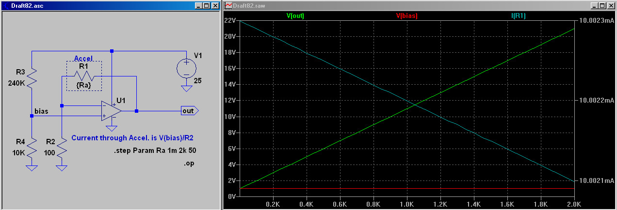

Here is a circuit I have seen used with similar accelerometers. I think I saw it on some application note, long ago.
This circuit simultaneously biases the accelerometer to operate with constant current through it; the acceleration modulates the effective resistance of the accelerometer and the opamp converts that to a buffered output voltage.
Note that by selecting the voltage at the non-inverting input of the opamp (1V in this example), and by picking R2, you can set the current through the accelerometer.
In my example, I choose 10mA (1V/100 Ohm). For the simulation, I vary the effective resistance of the accelerometer to see if the current remains constant, and to see the effect on the opamp's output voltage...
In the second simulation (time domain), I added a soft-start capacitor and plotted the current through the accelerometer at three different values of accelerator resistance (500, 1K, and 1.5K) as the power is first turn on. Note that the current comes up nicely controlled.
