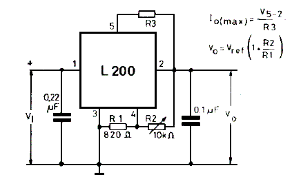

Hi As Some Of You Know Im Building a small 12 volt power supply i figured it well pump out 12 to 13.6 volt's at 1.3 amp's My Question is How do i lower the current with out lowering the voltage (I Think it is impossible cause of ohm's law but i dont know for sure)
I want to be able adjust the current output from 500 Ma to 1 amp
Or well it matter? Well the Device Just Use The Required Current it need's
I mean for this purpose simply solution the L200 chip.

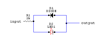

Do Led's act as regular diodes, If The Reverse Voltage is exceeded it well pass it and burn it's self up lol 8)
Yes indeed they do. LEDs, however, have much lower tolerance to reverse voltage. https://www.electro-tech-online.com/custompdfs/2003/11/107393PDF.pdf is a datasheet for a typical 11 cent diode. If you look down near the bottom of Page 2, it states Reverse current @ 5V -> 10uA. This means that if you allow more than 10uA through it backwards, it will likely be destroyed.
If you know that your LED is going to be in a situation where it will be reverse biased, your best bet probably to have a different diode (such as a dirt cheap 1N4004) connected backwards to your LED. (See attached picture). This way, if the has a voltage greater than the output (and the difference is greater than Vforward), the LED will light up. If the output is higher than the input (and > Vforward for the diode), then all the current will be pulled away from the LED.
