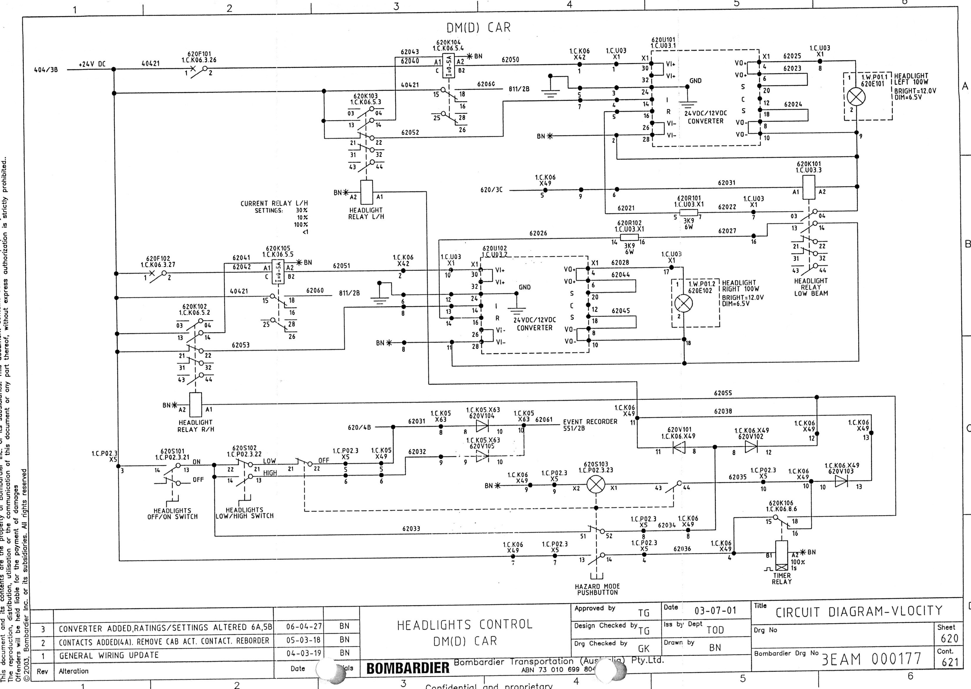

if i put it simpler, it's a form of relay that measures current flowing through a wire. when the current falls below the custom-set level, a contact closes. this method is used in real-life. In my case, the contact is open at 8.3 amps and closes at less than 8.3 amps, illuminating a fault light. the diagram should help explain.
I made a current relay a few years ago to measure the current taken by the fog light on a trailer. That turned off the fog lights on the car, so that the driver didn't get dazzled by reflection from the trailer. Also doubled as a blown bulb detector for the trailer foglight.
I unwound a standard automotive relay, having measured its resistance. I then rewound the relay with the same number of amp-turns. It worked fine.
However, modern high side Mosfet switches like these:-
https://www.electro-tech-online.com/custompdfs/2008/02/ips521.pdf
have short circuit, and open load detection, so it will tell you if the bulb is blown.

Relays work by current not voltage. (amp turns) I know some one will argue they work by voltage. “12 volt coil” It is amp turns.
The current (voltage) it takes to close a relay is not the same as the current (voltage) to open the relay. If a relay is rated to pull-in at 8 volts it will probably hold closed down below 4 volts. I know you want a relay to close at 8.3 and open when there is less than 8.3. A relay is not going to work like that. Lets say you found (made) a relay that trips at exactly 8.3. If you start out with 0 current and slowly ramp upwards the relay will close at 8.3 and remain closed above that. When you start reducing the current from 10 amps downward the relay will be closed at 10,9,8,7,6 5,and 4 amps and may open up at 3.5 amps and below.
I do not know of any mechanical relay that will be open below 8.3 and closed above 8.3. There are relays that will be open below 3.5. Closed above 8.3. Between 3.5 and 8.3 could be open or closed. (will not change state, will hold where it is)
It doesn't matter much for this application if there is a big gap between the turn on and the turn off voltage.
Headlights take lots of current on turn-on, enough to operate a current relay even if the relay needs a lot more than 8.3 A to turn on.
When a bulb blows, it almost always drops to no current at all, so any relay will drop out.
If there is some reason that exactly 8.3 A is important, then a relay would be useless. However, the current in a 100 W 12 V bulb will fluctuate around 8.3 A depending on temperature, age of the bulb, and supply voltage. The voltage on a car battery varies a lot, so the current could be as low as 4 or 5A and the bulb could still be OK.
i'll make it 'contact open when current flowing through, contact closed when no or 0 current flows through' yes?
