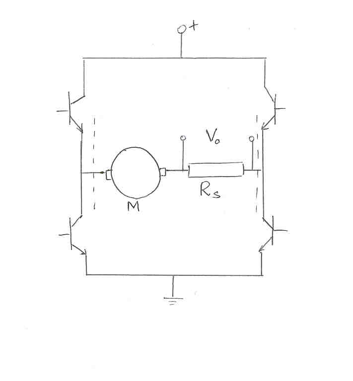

Hi Guys,
I have to control a motor bidirectionally and measure the current through it.
I am using the connection as shown here

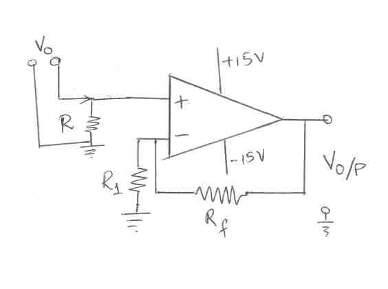

The voltage Vo is applied as input signal to opamp in noninverting amplifier mode.(i.e one terminal to pin noniverting while the other is connected to common ground of the opamp) The problem arises when the motor is operated in the reverse direction as the common ground of the opamp ( connected to shunt resistor) is connected to the high voltage side of the motor driver. I noticed that the motor is uncontrollable at this stage and runs at full speed.
COuld someone suggest an alternative method to measure the current bidirectionally using a shunt resistor itself?

Either use an a high Common-mode rejection "instrumentation amplifier", or build one yourself using a conventional op-amp by matching four resistors to 0.1%.
