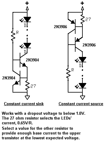

A current sink circuit pulls down, it is on the low side.
A current source circuit pulls up, it is on the high side.
Here are both as very simple constant current LED drivers:
