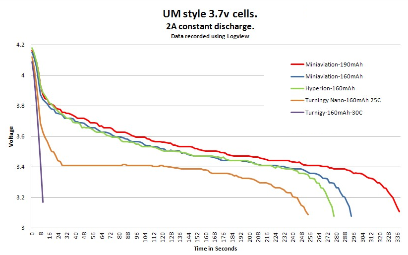

Hyperion is one of the best small Li-Po batteries for radio controlled model airplanes and helicopters. Its tiny connector and wires on the connector limit its current. If shorted its wires burn off the insulation and glow red hot.
Here is a graph showing its 160mAh sister providing 2A for longer than 4 minutes. The purple line is a poor quality Chinese one from Hobby King. This 130mAh battery will have the same timing and voltage when its discharge current is about 1.6A.
But instead of paralleling two of these small ones why not use a larger 240mAh or 300mAh one?

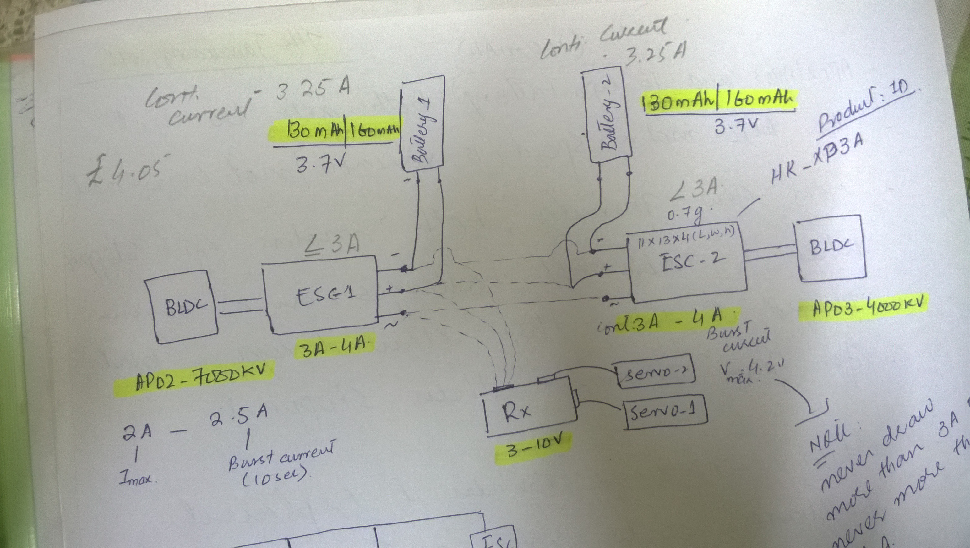

well, this discussion has been helpful. I need to confirm you guys to have a look at this circuit diagram to ensure if connections are fine ? n if there is any short circuiting or break?

It is not safe to connect two Li-Po batteries in parallel because their exact amount of charge probably will be a little different. Then an extremely high current will flow between them where one will discharge while charging the other. Their connectors and wires will probably be damaged by the extremely high current. Use one larger battery cell with a higher capacity instead.
You don't do this with LiPo batteries - you didn't make this clear at the beginning.
Assuming you want to parallel ANY batteries though, they should be identical, permanently paralleled, and charged like that - BOTH must have identical charges.
But Li is a special (and dangerous) case.
