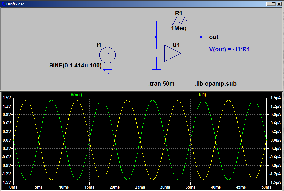

To me, this is the prototypical "current-to-voltage" converter:
That circuit is really, really cool! I have it nailed except for the purpose of R2 and C2.
Thanks Mike, I could see that the circuit from #1 has two different modes of operation. For high current it watches the voltage across a resistor, amplifies and outputs. I just could not see that in low current mode it works like what you posted. (#8)
A real easy way of visualizing the above post (standard transimpeadance amplifier) is:
The (-) terminal is held at ground. I and -I1*1M sums to keep the (-) terminal at ground (Vos really). The current into the op amp is CLOSE to zero. The OP amp must be capable of sourcing/sinking the current being measured. Vos and Ib are important parameters. Ib is a function of temperature.

Yes, its interesting indeed.
But did you notice the capacitance of the photodiode is a major problem , https://www.electronicdesign.com/analog/whats-all-transimpedance-amplifier-stuff-anyhow-part-1
