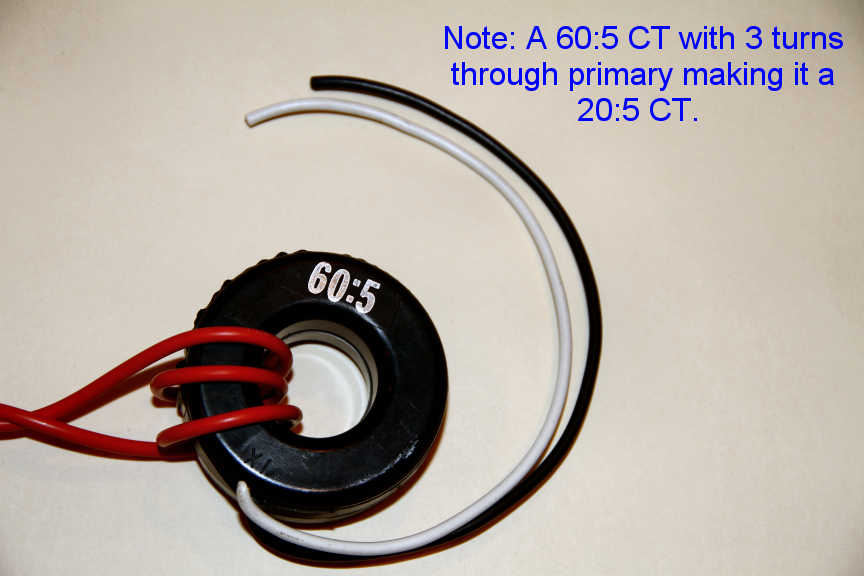

I'm looking at two projects, both of which appear to require current transformers. The first is to detect the current draw of a AC motor, which is expected to be 10-15 amps. I would like to install a 20A AC panel meter, but the ones I have found all state they require a current transformer. How do I determine the specs for the current transformer?
The second is to determine whether a piece of equipment is on or off. When on and idle the equipment draws a low amount of current (~1A), when off it draws nothing, when running it may draw 5-10A AC. Really I'm looking to tell the difference between 0A and 1A and don't care if it is higher than 1A. The remainder of the circuit I have, I'm just looking to determine how to spec the current transformer for this system as well.
For part two I use these little units. They will give a visual indication of any current flow above 0.75 amps (CR2550 version) and don't cost much at all. Hell if you want one just ask, I have several lying around. I have yet to cut off the LED and scope the leads but would also venture a guess if the LED was removed they would easily drive an opto-coupler for more elaborate setups.
As to the CT aspect. The CT will be specified like for example 50/5 or 100/5 meaning that a 50 amp primary would yield a 5 amp secondary. They are easily scaled. I would suggest for your range (10 to 15 amps or so) using a 50/5 CT. I would suggest one like this one from Simpson but many companies make the things. Here is the data sheet on the linked to unit.

Another common trick using a CT is to for example wrap a few primary turmns through the CT.So if you have a 50/5 CT but never expect to go over 25 amps then wrap 2 primary turns so now uyou have effectively a 25/5 CT.

<EDIT> I got home from work today and looked at the bucket of CTs I have lying around. Over the years at work I have been eliminating the old CTs for newer current transducers that give me 4 - 20 mA out, units along these lines. However, I lack the guts to toss the CTs in a dumpster. :)
Attached is a 60:5 CT image. I ran 3 turns through the primary as I mentioned earlier so as pictured it becomes a 20:5 CT. If something like this would help in your project just send me a PM and it's yours for the asking. I'll never use most of these things in my life. All I ask is that you use it and let me and the forum know how things went.

If I did two turns through the core, would that reduce the turn on point to 0.375A? Or does it not work like that? The issue at hand is to make a remote indicator that a machine was left on many many feet away (50-100), so I think you mentioning the optocoupler will be a good solution to my distance problem.
If I recall correctly I did try with a few loops through the center and it did work. I just am not sure. I have been wanting to get around to cutting the LED off and using a scope to see what the signal looks like. If they are just half waving a AC small signal the LED would be pulsing. This is why I wanted to get around to looking at the output with a scope to see what is actually there. Unfortunately sometimes real work get's in the way of my playtime around here. :) Maybe I'll make time today to confirm my suspicions.

What I noticed during my brief playtime was that adding a turn when at minimum just about doubled the LED intensity. While normally rated for .75 amp they do give light as low as .5 amp just real dim. Adding the amp turn doubled what I had. As I mentioned, if you want a few let me know, you can play around and see if they will do what you want.
