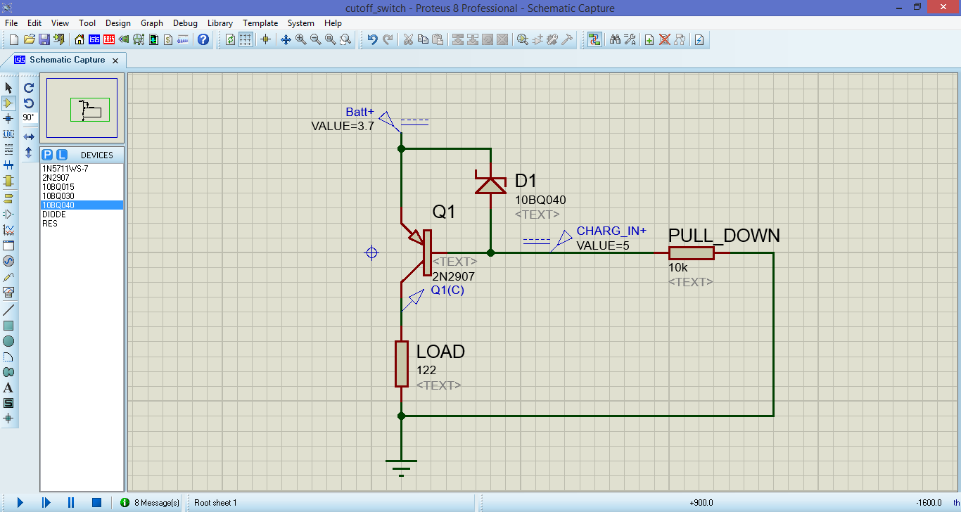

I want to cutoff the battery from load, while charging it. Schematic of the designed circuit is attached. I have used a PNP transistor to do it. Positive terminal of the battery is connected to emitter, charger positive input is connected to base. Simulation is running good but I want to know would this circuit work in hardware? Is there any problem with the circuit?

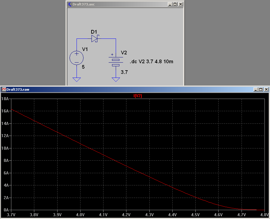

I cant see how this will stop charging the battery until the voltage reaches 5V-(forward drop of a Schottky diode) or about 4.8V.
Unless I dont understand where you are connecting the battery, your circuit simplifies to this:
The problem with your original schematic is that it says "Charger Value= 5V" which is WRONG. It should say "Charger for single Lithium battery cell".
