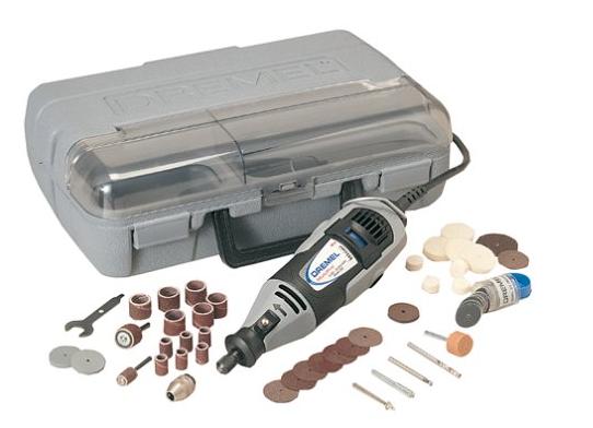

thanks , could you post a picture of your cutting tool with a table . I cant figure out how to put all things , I need to cut a lot boards and they should be all the same size .

a dremel is a hand tool they can be bought at pep boys and sears and such..the one i have did not come with all these attachments.. but you can find them individually...
its not the fiberglass that dulls your blades , .. its the copper..
