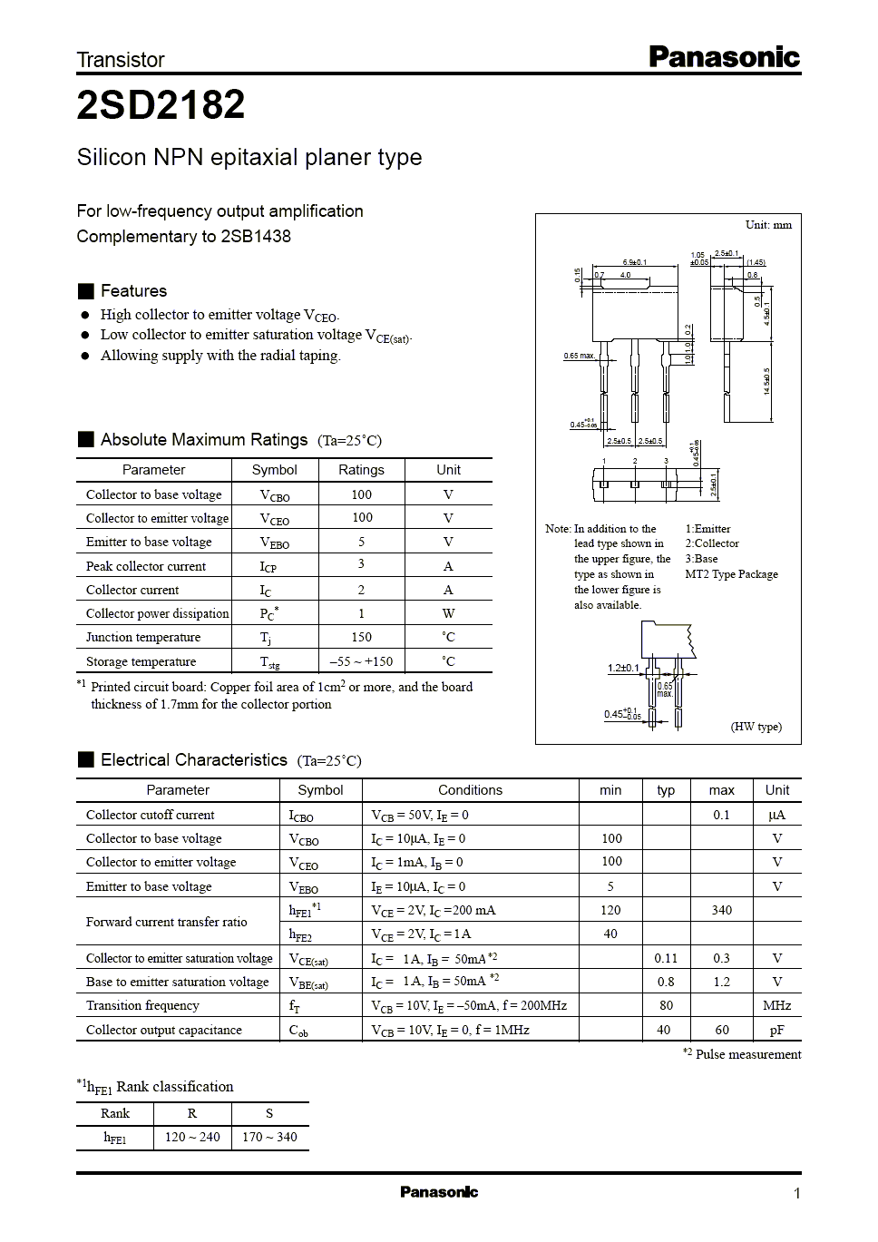

D2182 datasheet?
epilot
hello
i bought 10 of "D2182" transistors but i couldnt find ANY datasheet for them in the net??? :(
i dont know why there is no data for them on the net?
thanks for any input.

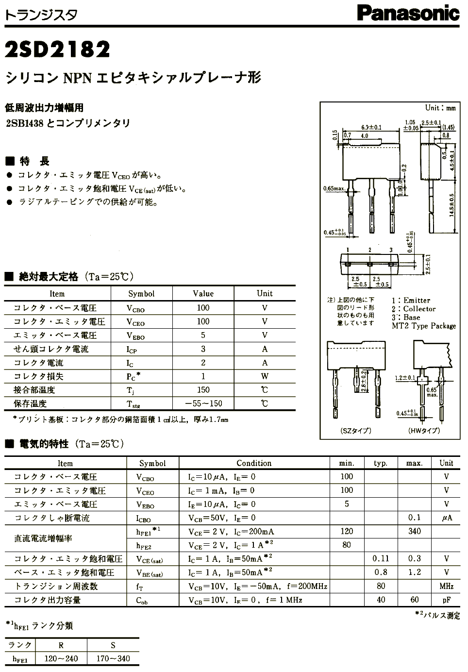

Maybe You bought as rest of repair service. This type often used only in Japanese videos.
  • 2sd2182.pdf
ok thanks "Sebi" and "hotwaterwizard"
it was what i wanted to know thanks again

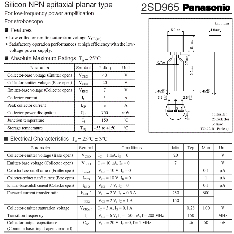

but i have a question about datasheets too.
i have a RX(receiver) that its original output transisors are not good for a dc motor and the folks in other group suggested a IRLML2502 MOSFET
such as i know it is a very good think for the output because of its low resistance for output, but i can not get it so i want use one of "2SD2182"
or "8050" or even "2SD965 "
but i dont know which one is better?
the current draw of the motor is about 1A so all above transistors are good my problem is that i dont know with which one i can get the most output current and voltage like IRLML2502 MOSFET?
what is the base of low resistance of bipolar transistors???!
i hope i could say my mean
what is the best bipolar alternative for IRLML2502 MOSFET?
thanks.

UCEsat is the saturation voltage of BJT: when the transistor totally open, this voltage can be measured between emitter and collector. This voltage multiplied by collector current, give the power dissipation of transistor.
See the crop of datasheet: UCEsat typically 0,28V, but the max. (worst case) is 1V. When the collector current 1A, the dissipation 280mW: this is good, but in worst case (1V), the dissipation 1W! The d'sheet give also the max. rating of dissipation:750mW, so the transitor make a smoke.
Why better the FET? The same parameter called RDSon, this is a resistance value, and You can find some types with 0,001ohm value!
Just use the ohm's law.
So, if You have a good 2SD965, just try it.
