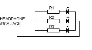

Okay I have been looking around for a while on the net and I cannot find a detailed enough answer or they're just pictures of what they made, basically I want to make a circuit where like a red light flashes to the beat, and a blue light flashes to vocals or higher pitched noises and green for middle somewhere:
:mad::D;)
Now the best I could come up with was my circuit diagram, now for example R1 would be more than R2 and R2 higher than R3:
R1Ω>R2Ω>R3Ω
or
R3Ω<R2Ω<R1Ω
and if the LED recieves enough power then it lights up.
thanks in advance for any help
Just use band pass filters with the LED's.
This one uses coils to and capacitors to pass\restrict
I'm having a hard time finding the calculator that just uses capacitors and resisters (simplest to construct). I'll keep looking and post it if I find it. You can probably drop the resistors if you just using regular line level output. It will take away sound quality if you are amping the signal from the same line.

A VU meter circuit using an LM3915 has a range of 30dB which is 31.6 times. Each frequency band could have one.
Two LM3915 ICs can be cascaded to have a 60dB (1000 times) range.
three LM3015 ICs can be cascaded for a 90dB (31600 times) range.
You are looking for the classic "colour organ" or "color organ" circuit. We built these for small coloured lamps 30 years ago.
Here is a complicated one:
Here is a collection of circuits:
Color Organ Electronic Circuits
This is the type we built when we were kids:
Color Organ
If you are using LED's you need to make some changes. here is one example:
The Electronic Peasant's LED Color Organ Page
So for that one you said you built as kids, do I connect the Speaker wires to the 8 ohm end of one transformer, but the other 170 V isolation transformer goes to nothing am I correct?
