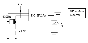

I'm using two PIC12F629A with two receivers of my RF module and they worked fine a few days ago. Yesterday, I tested them again (without reprogramming them) with the RF module, they didn't work, both the PIC's!!! That IC has only 8 pins, so I'm sure the connection is correct. And I found that the PIC is getting hot.
Then I remove from the breadboard and reprogrammed it (with the same .hex file) and plug into the same hole of the breadboard, then one worked and the other PIC is burned.
How come this can happen? Has anyone had this problem too?
EDIT: Before they're reprogrammed, the ammeter from the PSU showed 1 A when it is turned on, then I quickly turned it off and removed the RF module, turned it on again, the current was still 1 A. So that must be the PIC's problem. It is okay after being reprogrammed.
Sounds like you didn't put a current limiting resistor on an I/O that needs it and shorted the supply to an I/O pin.
In order to figure out where the fault is you're going to have to post a complete schematic of the entire circuit you have so far.

I didn't include the current limiting resistor for the LED, is it the main reason? If it is, now only I realize how important it is. Then I should always put the resistor for good practice.
Oh yeah, you HAVE to use a current limiting resistor on an LED, and many other components and data interfaces. It is just a diode after all, there's no limit to how much current it will let through, there is however a limit to how much current the I/O pin and the LED itself will let through before burning up.
Thanks for that, I'll use a 220 :eek:hm: for that.

Simple knowledge of a diode's V/I curve will easily tell you that you need a current limiting resistor. If this isn't taught in school....
The 12F629 has a built in 4MHz osc, it's accurate enough for flashing an LED.
You'll also need a 0.1uf decoupling cap across VSS & VDD

Oh it means a simple LED can burn a PIC!!!
I think the problem is not LED cuz if LED is the problem then it should be demaged one I/O port, not the whole PIC...
I think the problem is, u have applied more than 5 volts to PIC VCC...
No, I'm sure. Definitely not more than 5.1 V :D
