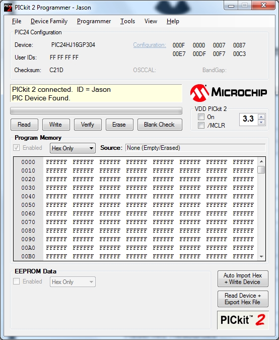

I jut got my first 16bit PIC the PIC24HJ16GP304 which seems to be a nice PIC... But the datasheet tells me for ICSP i have these pairs:
PGD1/EMUD1
PGC1/EMUC1
PGD2/EMUD2
PGC2/EMUC2
PGD3/EMUD3
PGC3/EMUC3
I understand i can use either pair. But on the PINOUT these pins are non existant.. They do have other similar pins like:
PGED1, PGEC1...
I assume that did a TYPO on the PINOUT since they refer to these pins as PGD*,PGC* throught ICSP info.
So you think its a typo and i should use the PGED*,PGEC* (on pinout) ?
I think this should help. It is in the same datasheet. It seems they still have some errors with the old names.

Well are you going nuts - I better not comment :D;)
As for the programming pinouts -yes you are right in your icsp connections - don't forget to select which pair you are using in the Config statement.
Sure you will have seen it, but this is a very good Pic24 tutorial with hardware and software, have done all the experiments but yet to prove the Ethernet one, bit beyond me on the pc side.
Thanks guys!!! not really going nuts tho... (heh)....
