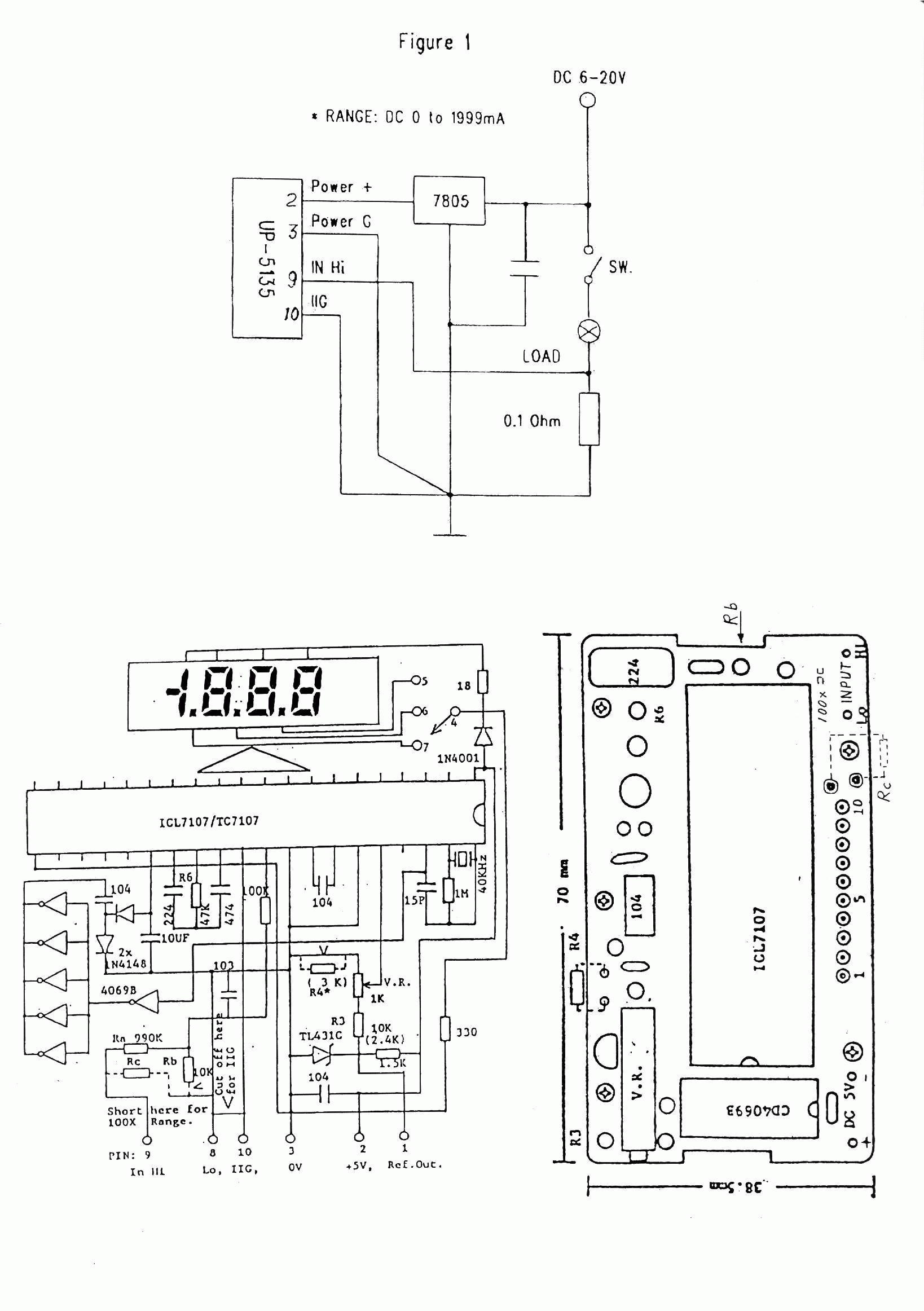

UP5135 Volt Ammeter
Hi
I found this post before receiving the connection details.
For anyone else pls find the circuit connection & wiring diagram.
regards
  • UP5135 DC20v 100A meter.pdf
