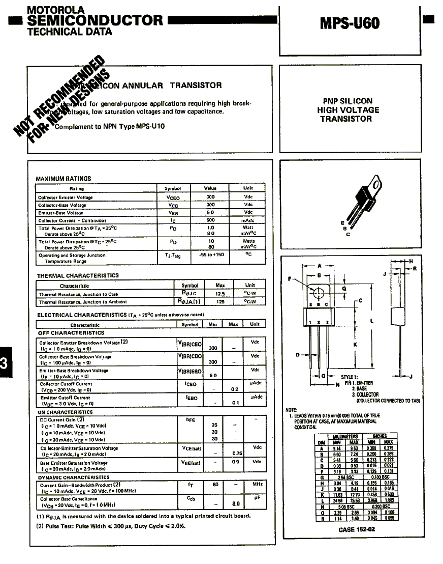

I found MPSU60 Datasheet which is the PNP compliment of it.

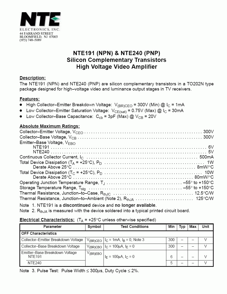

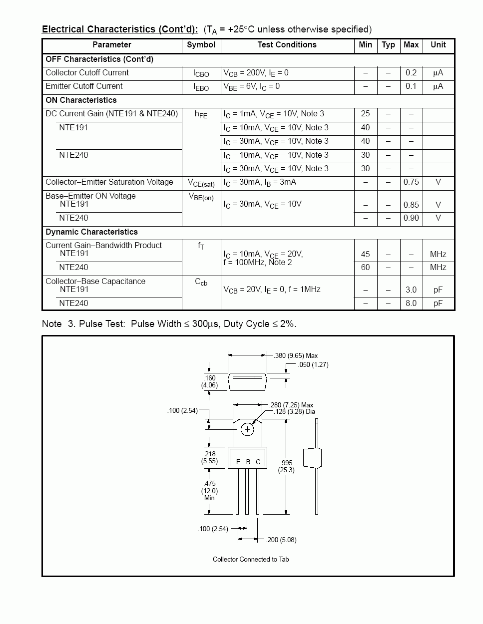

Here is NTE191 Datasheet . It is the Generic Replacement.
  • nte191.pdf
Here is a Different Format
