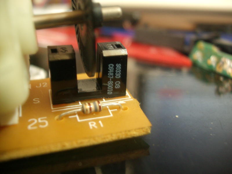

eh i feel dumb doing this but i need help finding out the info for this part:
It's an optical interuptor. One side is an LED, the other side is a photo diode or transistor, should be able to work what's what by looking at the circuit.
So it just counts am i right?
I can see which side is the diode through the markings on top. How do i connect the photo diode on the other side? (it has 2 pins) should i like pull it high and then when ever the pathway is clear it connects the pulled high side to the PIC?

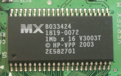

How about that chip i know its memory but i cant find a datasheet
The other chip is a 16 bank 1mbit (128kB) sram chip. Didn't try to look for the PDF too hard but it's useful if you can interface to it.

The OptoInterrupter has 5k resistance on the transistor side. Is that normal?

I wish i knew how to interface to it also :D
For and SRAM chip like that Atom, unless you can find PDF's easy, ditch it, they're cheap to buy new with full support, and you can get them in DIP form factor still, though I somehow don't think you're afraid of surface mount =)
5K sounds normal to me, is it on the emitter or collector side?
I tested across the pins.

Notice how many slots are in that wheel, you could easily swamp a PIC wither interupts if you spun the wheel quickly, just keep that in mind.

Or you can use one of the PIC's timers in counter mode. ;)
Depends on if the timer is synchronous or not, depends on a lot of things actually, like how fast you need to spin the wheel, what resolution you want and the frequency of the pic (if it's synchronous)

He'd have a hard time overwhelming the hardware timer on a PIC with a mechanical wheel and Opto encoder. Most of the PIC frequency counter projects, which work up to 40-50Mhz, use the hardware timer and prescaler at much higher frequencies than AtomSoft will ever see from his encoder wheel.
