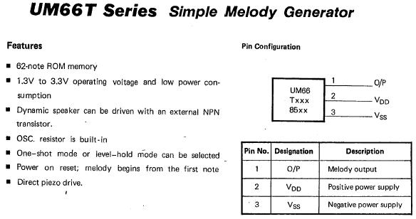

If i remember well, the pinout is same,just a melody different....
