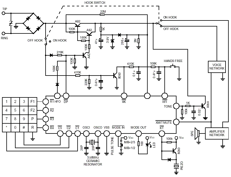

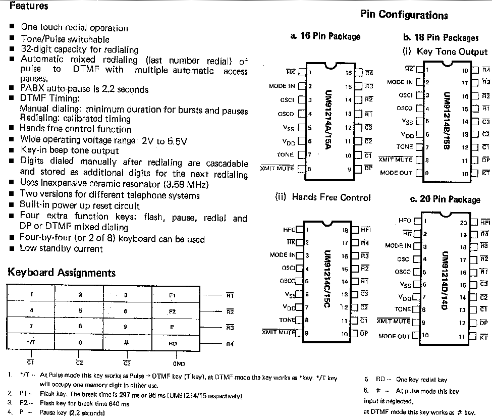

I'm an electronics Newb.. Wanna have datasheet of UM91214/15 DTMF dialer. I have one that does not have sample application circuits..so t'll b helpful if i get one that has some test & application circuits also..

Can i get an application example...coz i'm xperiencin a littl bt of problem while :wink: usin it to generate and "send" DTMF tones...

I'd like to have application circuits of 91214/15 where the IC is "fed" by an external power supply rather than deriving its Vcc from the Tel. line itself. It'd be really helpful.

hi sebi,
i'm interfacing tel. line with UM91214 for dialing numbers through the line.
Also i'm using a microprocessor(8085) to dial different digits (shorting different rows and columns)............. 8)
So i've given 5V from RPS to pin 6 of UM91214 as the supply instead of taking it from tel. line....... :shock:
And trying to give the tone output of UM91214 to the tel. line through a transformer as shown in https://www.electro-tech-online.com/threads/monitoring-phone-in-use-via-serial-pc.9273/
Is this OK?
do i need any modifications in my circuit?
Or is it compulsory to use UM91214 in the above circuit (as the application example given by sebi)only?
Please help me in this regard.......
