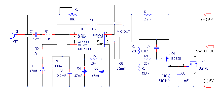

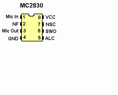

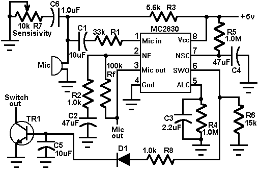

Here you go.

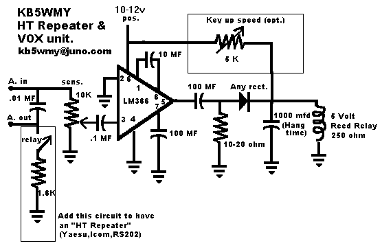

thanks, but l thought that was just the whole circuit for the voice activation switch of which i want to know whats inside the mc 2830 that is the datasheet of the chip without the circuit. in addition for the switch, l was contempleting on using a comparator which act as the Vcc to my aoscillator once someone speaks into the microphone. is that feasible?

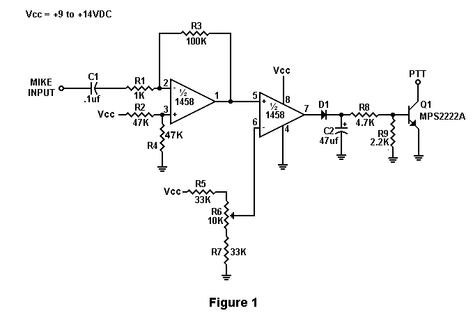

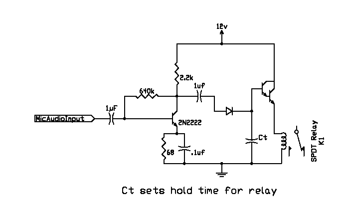

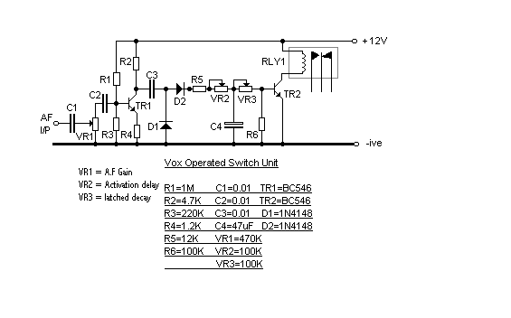

I have a few Vox circuits.
