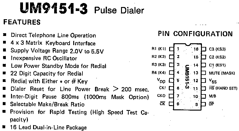

iam looking for pulse detecting IC which i can use in my telephone set...
I got the following IC from a old telephone set but iam unable to find ts datasheet can any one please tell me how to get the following datasheet
BT9151-3
9151 not a pulse detecting IC, it's a pulse dialer.

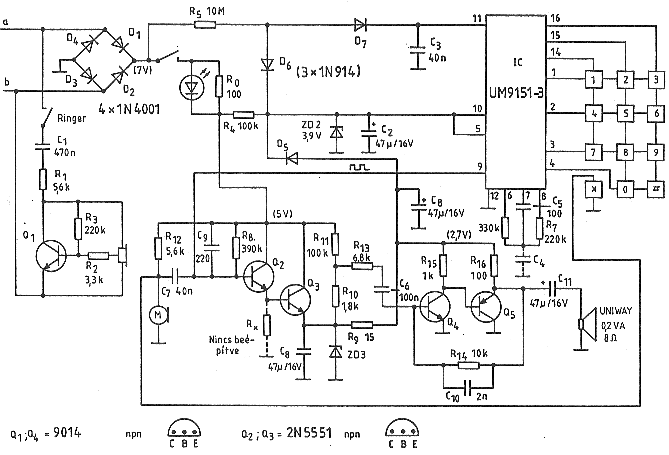

how i can make use of redial using the same iC
firstly thanks a lot as i really worked hard to get this IC but unabel to find it. Can you please guide me how to use this IC to create a redial option from the telephone set....i know its 8 or # but how to make the IC work for this.
Here is a sematic of chinese wall-phone as application.
