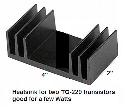

thanks!! now i understand!! i think the 2 watts operation with heat sink is enough and not destroy the transistor!!

Use a larger heatsink because the transistor will last longer if it never reaches its maximum allowed temperature.
This heatsink will be fine:
