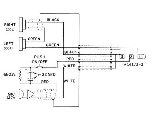

Well, the Clark headset schematic is below. The drawing only shows one connector for both headphone and mic. The other head sets have two connectors. Also I did not know all headsets use the same .206" plug. Do they all handle 4 conductor like the one I linked?

The connector you linked off EDMO only has three connections, tip, ring and sleeve. That second ring is not hooked up. There are only three terminals under the screw-on barrel. How are you going to add the switch?

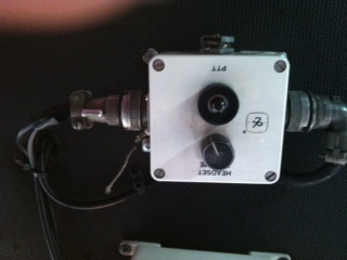

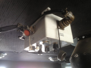

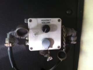

I got a chance today to look at the setup a little and took a few photos. Basically there is the master unit U3800 and some other small boxes distributed in the cab, one box allows PTT with the radio, the other boxes just do intercoms within the engine. I am attaching some pics. I only could find a number on one of the small boxes, U3811.
So what I am looking for is a way to get headsets cheaper than the new David Clark ones. But not sure best way to go about it.

Here's the thing, we picked up our pumpers used. They came with the David Clark intercom system (U3800) but no headsets were included. :mad: From what I have seen in other setups, all crew members in the cab can hear the audio from the radio, but not all can talk over the air, usually only the driver/operator and captain seat can. All members however can communicate via headset to one another with a mute function on the headset. In our cab their is a Box labeled Spectra with a PTT switch which I assume is for over the air. If I been reading the David Clark website correctly, we need H3000 series headsets or equivalent. David Clark is just so darn expensive, not as bad as Bose but still pricey. I am hoping to save at least half that, though might not be possible.

From my experience on engines, we can talk and speak locally unless we depress the mute button which blocks our voice transmission. The mute button is on the headset. This is intercom only and not over the air.

Okay, the aircraft headset does not have a "mute" button. No reason you couldn't add one. I am guessing all it would have to do is break the wire between the mic element and the plug. If you didn't add a mute switch, all headsets would have a hot mic all the time...
