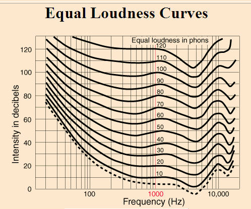

That's not really accurate. There is still a heavy frequency change for human hearing even at relatively loud levels of SPL. Attached is the standard "equal loudness" curve for human hearing I have always seen used for reference. You see large magnitude changes from low frequency to high even at the highest SPL level on the chart which is 120 dB. That is a pretty loud level, most people would not like to hear it for long. At SPL levels which are nearly deafening, the frequency contour does continue to get flatter but it has to be dangerously loud.

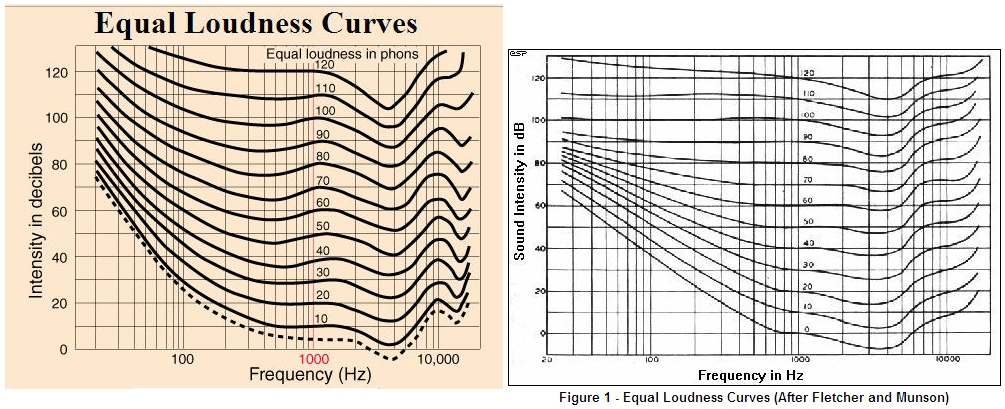

I don't know whose curves are correct.
The one on the right looks to me like an approximated copy of the real one, but the one on the right still shows a 20dB difference between lowest frequency and the SPL at 4K Hz so there is still a significant variation with frequency at 120 dB.
I remember from back in school (35 years ago) seeing the ones on the left in our book except the family of curves extended upward to higher SPLs like 140 - 150 range and those were getting flatter. I remember asking the teacher how they got volunteers for the testing at those levels because their ears would probably be damaged. I looked yesterday and I didn't see any curves above 120 posted anywhere anymore probably because they aould be too dangerous to take the data.
