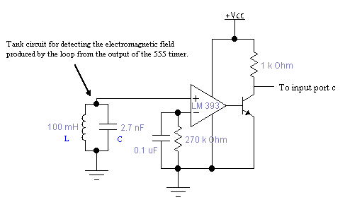

You mean the resistances for both the inputs of the comparator should be the same? But in my circuit, non inverting is conected to the 100k and the 0.1uF to the GND. While the inverting input is conected to a tank circuit. How can their resistance to be the same? The circuit works well if i replace the 100k with a 270k.

Can I see the circuit? If you did not design the circuit (I am assuming you didn't since you don't seem to be sure about certain things), then the designer might have already compensated the impedences at the inputs for you. That is probably why the non-inverting input is connected to ground through a capacitor and resistor. From what it sounds like so far (as far as I can say without a schematic), it seems the circuit would work just fine if you connected the non-inverting input straight to ground. Then the reason the capacitor and resistor is there is to compensate for the impedences at the inverting input. It may have already be done for you.

this is the circuit.

The PNP transistors at the inputs of an LM393 have a typical input bias current of 25nA. You want the output to be low without a signal so the inverting input must be biased at least +5mV to cancel any input bias voltage and a little more to cancel any input offset current. The 270k resistor raises the voltage at the inverting input to typically 6.75mV.
Your circuit doesn't want the resistance at both inputs to be the same.
Yeah, it looks like your circuit wants a non-zero bias, so the impedences on + and - can't match. If you wanted to get as close to zero bias as possible by compensating for bias currents, that's when you make the + and - input impedences the same. But that's not your case.
