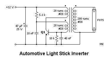

I recently learned to couple coils in LTSpice to make a transformer using "K1 L1 L2 L3 1" command then started to experiment/simulate DC ballast and AC to DC simpler SMPS. These devices has similar transformer with 3 coils- 1) flux generator, 2) feedback and 3) output.
Using same type of command I got two coils transformer working but using same type of command 3 coils transformer circuit is not working. In real world, these Devices are working. I also got failed to simulate AC to DC SMPS with 3 coils transformer.

Simulation file is in the post #1 and here is the circuit of the simulation (for Quick view)-

Try reversing the polarity of L1 or L2 and increasing the value of L1 to, say, 1mH.
As alex_t said....reverse polarity of L1 or L2, but change L1 and L2 to 1mh, and L3 to 100mh
Yes, I just reversed L2 (main flux generator coil of 40mH) and it's working! It is amazing that I made a circuit posted in #2 and it's working (lightning 20 LEDs bulbs in series from 12 volts, total LEDs forward voltage became 48V). But simulation needs 'reversed inductor'. I carefully saw phase dots of circuit at #2 post and made successfully. Can you guess why simulation needs reverse phase dot inductor?
(I think simulation's phase dot is correct transformer however how I got the circuit at #2 working, wondering!)
