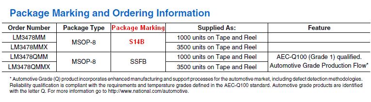

Success ... in the mean time, I've had a response from another forum that I frequent .. and I've been told that it's a National IC .. LM3478
https://www.electro-tech-online.com/custompdfs/2009/05/LM3478.pdf
I've asked how he knew .. but haven't had a reply yet.
The data sheet lists the numbers that I was after ... the thing that amazes me is why they bother to put some dud number on it when there was room for the proper number in the first place.
Any way .. this one is solved .. but stay tuned, I'm always on the look out for some odd bit :confused:

Well. The Datasheet tells you it is marked S14B
Hi John,
Yeah ... I discovered that too, once I'd downloaded the datasheet .. the point is that I never would have discovered that if someone else hadn't told me what datasheet to look at :)
What I was saying that if they had room to write MNAJ S14B on the actual IC ... they might just as well have written it's proper name .. LM3478 like most manufacturers do on most components ... at least the ones I see. :)
I've just finished fitting the new IC and mosfet .. and it works ok ... hooray .. the interesting thing is that the new IC is labeled " MEAN S14B " ... which I figured is appropriate. :)
