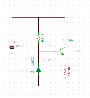

you can use a simple transistor zener diode circuit like this one. the zenner diode should be Vout + 0.7
