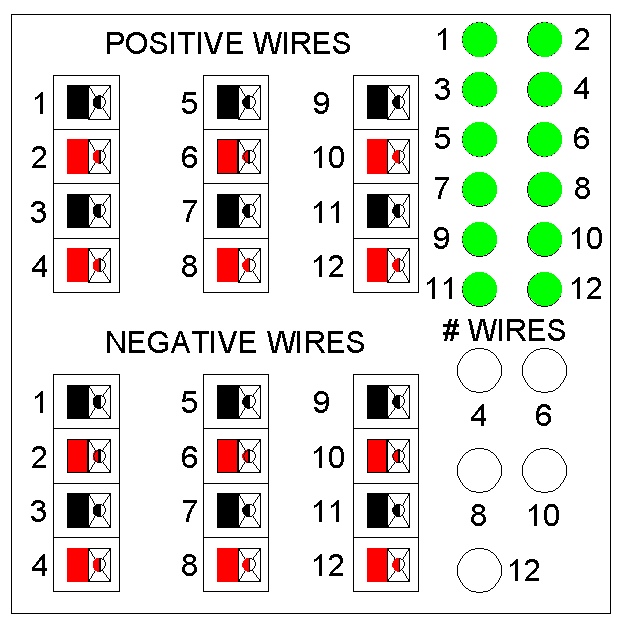

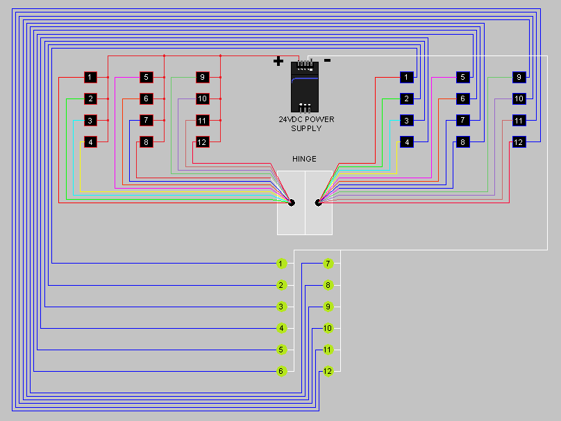

Here's an image of the Autocad file for the circuit. What I was hoping to accomplish is that each "terminal" corresponding to a particular "through wire" will light the LED. If a wire fails, the LED will obviously go out. The reason for the relay was to power a relay, of which I could use a set of N.O. contacts to control the "enable" circuit for the swinger. When the light fails, the motor stops, the count the swinger achieved prior to failure could be observed. Drawing.PNGEnclosure.PNG

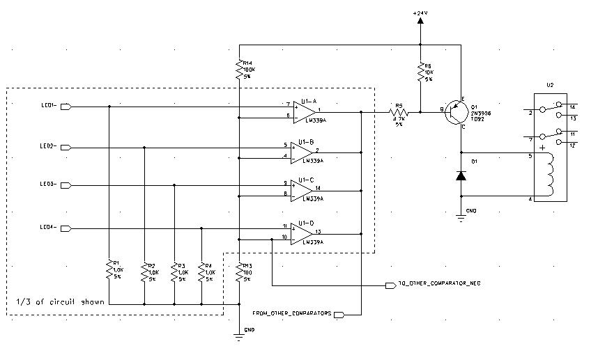

Thanks, Mike odom. You're the second person I've heard of the mention of "comparators". I had no familiarity with these at all and doing a little research over the weekend, agree that this would be the best approach. However, since I have never worked with them, your drawing is especially useful. Will the comparators have to be actually soldered into a circuit board, or can I just solder wire leads to them? Thanks
well, you can wire anything, but circuit boards make it a lot easier and cleaner... doesn't have to be etched, you can just buy simple perf board for prototyping and wire it together, but the board will hold all the parts in place. Note: not shown on the schematic are the power pins for the comparators... +24V = pin 3 and ground = pin 12.

yikes... I was just reviewing the schematic, and I got a decimal wrong... R1-R4 shouldn't be 1.0k, they should be 10 ohm. 33mA across 1k will try to drop 33v, not 33mV like I was trying to do. Across 10 ohm they will drop 330mV. That means R13 can be 1k instead of 100... this will set the reference input to 238mV. If the LED is on, the (+) input will be at 330mV, and since the (+) > (-), the output will be (+), turning the transistor and relay off. If the LED is off (open circuit), then the (+) < (-), and the output of that comparator will be (-). Since the comparators are open collector, you can tie all outputs together, and when one turns on the output goes low and turns on the transistor/relay.

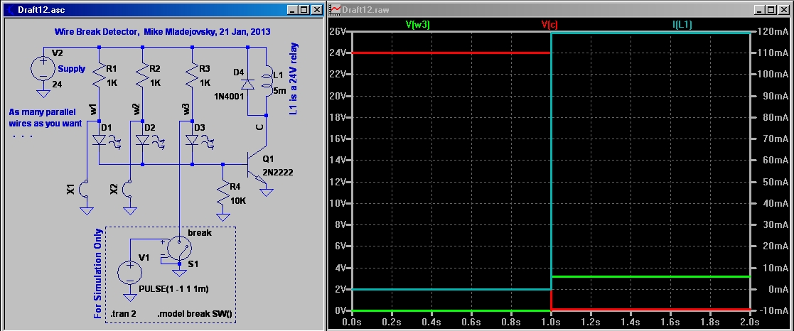

Here is a solution which is even "older school" (diode OR-gate), with way fewer parts.
Each wire under test ( you can have as many as you want, even hundreds) requires one resistor and one LED. Do not use LEDs that have an integral resistor; buy just bare-assed LEDs.
The wire shunts the LED while it is intact, and if it breaks, the LED current flows into the base of a single switching transistor, indicating which wire(s) broke in the process. For the simulation, I modeled one of the wires as a switch, starting out as a short, and simulating a wire break at one second. The relay pulls-in when the first wire breaks, so you can do what you want with the relay contacts.
