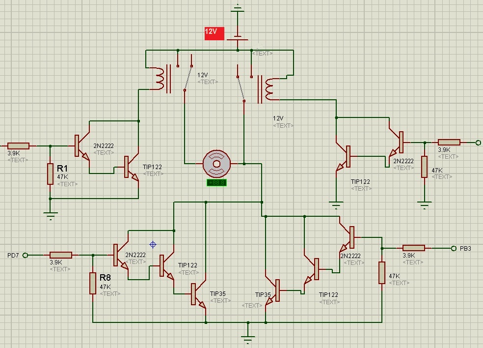

hi guyz ive attached the following circuit of h bridge designed by me using B.J.T`s plz comment about the circuit whether it is correct or not and also tell me which analogy is better to use should i use mosfet and a driver i.c or this circuit is better plz comment about this thanx a lot

I think this needs some modifications, first you will need diodes for protection check out L298 motor driver ic for more infomation regarding this
ya ive attached diodes also in proteus i didnt use them but in practical i will use 6A diodes but is it better to use B.J.T or mosfet circuit ???
if you use mosfet then you can use high curent motors without problem. But you may need to adjust input voltage to the mosfets gate to on fully. Normal power mosfet can handle more than 20 A , eg. IRF540. Transistors at that current are huge and you may need to input higher current than mosfet since mosfets are voltage driven.
