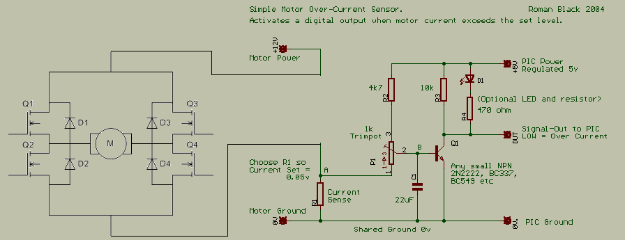

Hi all,
I have a motor which consumes approx. 800 milli-amp when operating. Now i need a circuit that will send 5V (logic1) to the microcontroller when the motor is consuming more than 1A. Do you have any idea of what components can i use? or do you know about a circuit that i can use for this application?

You can look at it this way. You can look into the various hall effect sensors out there for current sensing or you can take for example a precision .1 or 1.0 ohm resistor and measure the voltage drop across it in series with the load. 1 amp at 1 ohm = 1 volt or 1 amp at .1 ohm = 100 mV. Let's assume 0.1 ohm and use it as a current shunt. Now I would look for a good and simple to use instrumentation amplifier like the AD524 Precision Instrumentation Amplifier. While there are lower cost IAs I happen to like that one because of ease of use. A gain of 100 would give you 0 to 100 mV = 0 to 10 volts which can be fed to a simple comparator circuit.

You can do it with one transistor, provided you don't mind using the current sense resistor on the low (GND side) of the motor, and the motor PSU and micro share the same ground;
https://www.romanblack.com/current.htm
If i connect it as the attached pic.. will it work??

That should work fine using Roman's circuit.
Ron
Ok it worked. Thanks Mr RB :)
The only problem is that i cannot understand the purpose of resistor R2 in this circuit. Can someone explain to me please?
R2 produces a near setpoint voltage drop, thus reducing the value for the trim pot making trimming easier.

I like that it only needs to drop 0.05v to 0.1v on the current sense resistor to give a reliable detection.
It also works good on detecting filament fail (or wiring fail) on a remote light bulb etc.
