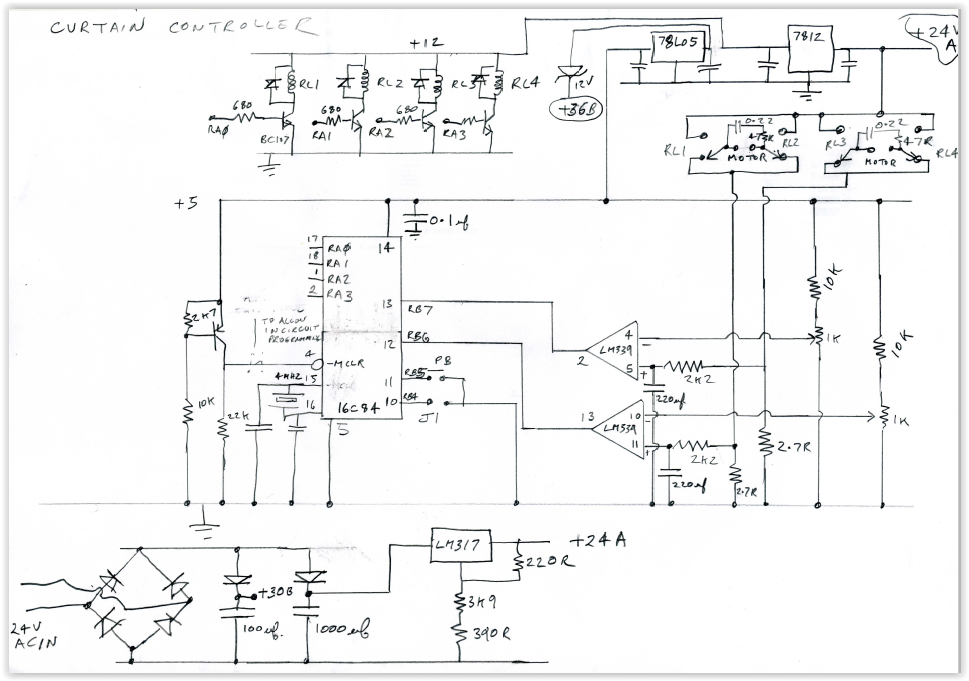

I have done something similar for controlling curtains. It just detected overcurrent by comparing the voltage drop across a low value resistor in series with the motor supply with a reference voltage. This was controlling two motors for opening and closing curtains. This is the schematic for the unit.
If you need to time that the overcurrent has occurred for 0.1 mS then you would have to measure the time with software in the micro controller. You would have to remove the capacitor from the comparator input for your requirements. (I fitted it to prevent the starting current of the motor from giving an indication of overcurrent.) I did not need to measure the time of the overcurrent precisely in my application. An alternative way would be to use the ADC in the micro controller to monitor the voltage across the current sense resistor.

Thanx for answer and suggestion. I studied your schematics(with my limited knowledge) and read datasheet of LM339.
So for my project, I suppose i need to connect out1,out2 of pic, to h-bridge(alegro A3901, A3903 ..) and h-bridge IC to LM339, next back to PIC to read values?

Hi Mnik1,
The LM339 is a quad comparator. You will only need one comparator (I only needed a dual comparator but I had the LM339 in stock so I used that.) I would suggest an LM393 (Dual comparator.) These comparators are open collector so you need to use a pull up resistor. I configured the pic to use it's internal pull ups which is why you don't see any on my circuit. I would suggest using a more modern PIC. The one I used was old when I built the unit about 10 years but I had it in stock. In my circuit the pair of single pole changeover relays effectively for an H bridge. I think the difficult part of your requirement is the need to detect the motor stall in 0.1 mS. You will need to think of a way to prevent the motor starting current from triggering the comparator. Is there one or two buttons to control it ? If it wasn't for the 0.1mS timing requirement then I think I would build it without using a PIC. Can you disclose the function of the item you are building in case this influences design decisions ?
