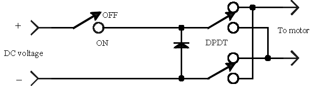

xiaobai00 said:
wont mind post some samples or sample circuit for motor reversing and forwaring?
Here is a diagram that works only on brush type DC motors.
